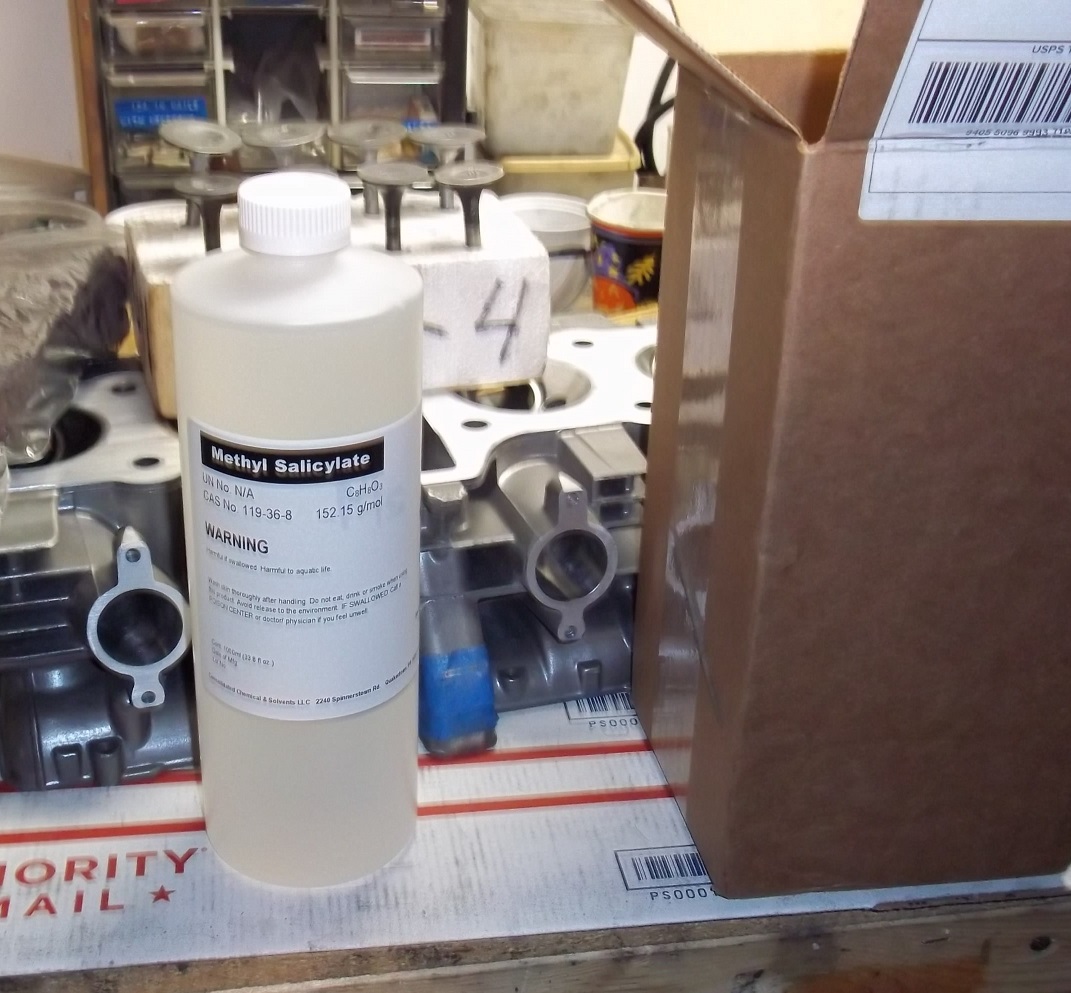

10 Jan 2016 06:31 - 10 Jan 2016 06:34Yes wintergreen oil! Did you pick up this info from our friend Nils? (NobleHops) he posted this from another forum.jdvorchak wrote: Just putting this out there. I have successfully revived rubber boots and other rubber items which are either too expensive to replace or no longer available. I used a 1:3 mixture of winter green oil and xylene. Soak for a couple of days and when dry they are like new and stay that way. Mix and keep it in a capped container because your garage will smell like spearmint or winter green chewing gum for quite a while.
www.cbxclub.com/forum/viewtopic.php?f=27&t=8753
I went right to the chemist! I purchased a 1000ml (33oz.) plastic jug of this 100% institutional grade wintergreen oil.
There are 4 oz. bottles for sale on ebay and amazon.
it is called (Methyl Salicylate) it is not un-stable, was able to ship regular USPS. MSDS was not too bad. when I get some other small containers, I might have some 4 - 8 ozs. for sale. does smell clinical! I opened it up and put a small amouNt in the basement tool room. Smells good!
MSDS reads HEATH -1 FIRE - 1 REACTIVE - 0 PPE - H.
