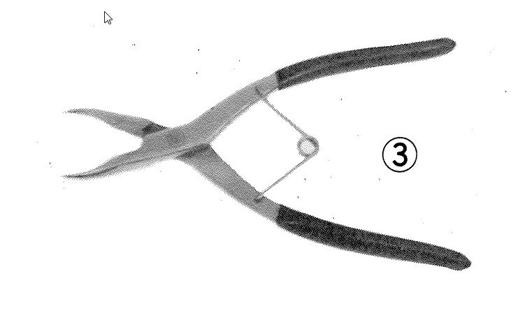

27 Jul 2013 01:28 - 27 Jul 2013 01:30Yes, it's s special tool.Schmeck wrote: What do you mean by raise the needles? Going through the top of my carburetor there is a ring that me nor the mechanic could get to . Is there a special tool for that ring ? My snap ring pliers dont reach it .
