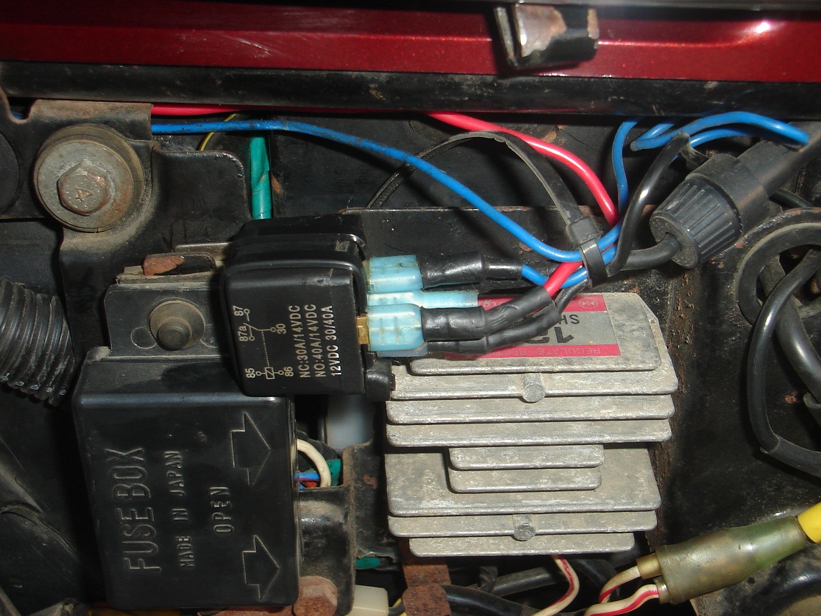

Trey, if you are using the "coil mod" you might check the relay. I had some intermittent current loss problems and traced it to the relay cap comming loose. Fixed it like this
and have not had any problems (with this) since.
Good luck,
Jim
Good luck,
Jim
