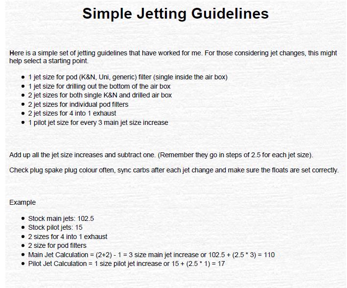

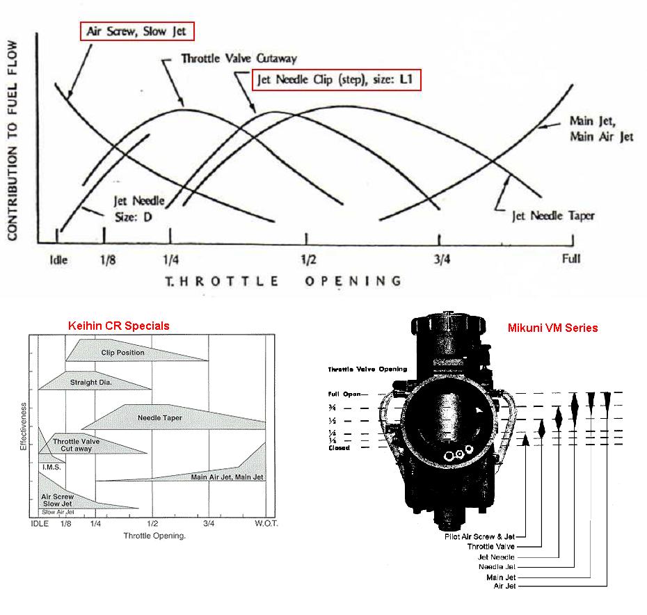

06 Apr 2013 18:30Old Man Rock wrote: Key notes to LEAN condition..... "Bike used to run well, and rev to the red zone with no problem. " & " discovered that float level was WAY high"....
Maybe this will help you diagnose your symptoms....
Basic rule of thumb for 4-1, pods (I realize you're using air box), non stock configuration jetting etc....
Follow this link for BS 34 re-build/tuning... One of the best write ups w/images I've come across...
BS-34 Rebuild....
