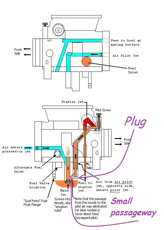

The OEM carbs for your year/ model llist the plugs. Now it is possible that the carbs are not the correct set for your year. Can you see the passage between the main jet and pilot jet wells? Easy to see with the bowl off of 1 or 4 and a mirror, with pilot plug removed.

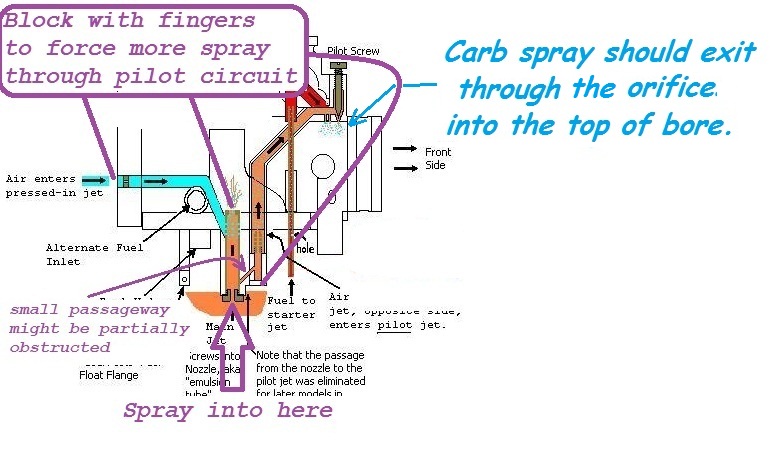

Am thinking the tiny passage is blocked that's supposed to supply fuel from the main to the pilot circuit.
Carbs won't perform correctly without the plugs.

Following up here I took the carb holders off and put some gas resistant sealer around where they seal on the intake and the bike would not start lol. Its running so rich that it wants to stall when I give to much gas. really sluggish then wants to go. Maybe now I should install those plugs. In order to get the bike to run right now i have to have my screws in all the way. I hope the plugs fix this issue. I looked down inside the pilot jet barrel and main barrel I did not see any hole that the fuel would be transferred from the main to the pilot. I guess I will see. Patton my bike is a 1983 are those holes there???

I had a GS1100 that wouldnt run because the air hole was plugged up. If you block the pilot jet hole with one finger and the hole where the fuel comes out in the carb with the other and spray carb cleaner in the air holes it should come out the idle mixture screw hole unless its plugged. I dont think you can see the hole. I had to saw an old carb in half to find it actually existed. I fished a piece of guitar string each way to clean it out. Whether its there on your year KZ or not I dont know. Its there on 83 Suzuki GS1100s though. I had the carbs & airbox off 9 times before I figured that out so good luck

The diagram at kawasaki.com shows the plugs and o'rings, which would indicate that the pilot circuit likely receives fuel via the tiny passage from the main circuit.

I must have some other type of BS34, because I pulled out the main and pilot and there is no hole. I inspected it for awhile thinking I was just not seeing it. I ran cleaner through there and nothing comes out the adjustment holes. I see on the needle jet where the hole should be but nothing is there. I dropped back to the stock mains that came in a bag when I bout the bike which were 120s and 37.5 pilots. I went back to 40 pilots and going to put in 140 mains. The bike breaks up bad when WOT. Low end is great. Better than when I bought the bike. Hard to believe that someone would have jetted the bike with that bad of vacuum leaks.

You may have a different version of the carb that does not require the plug. there were definitely some around.
