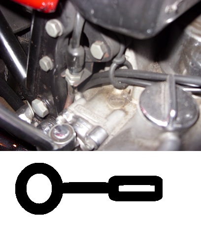

Thanks, JR. I'm going to keep the air box on the shelf and try the pods out. Was looking through the shop manual and rejetting it doesn't look too bad.
I've been tearing the bike down and have easy access to it right now:
