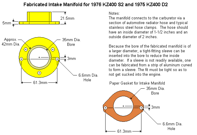

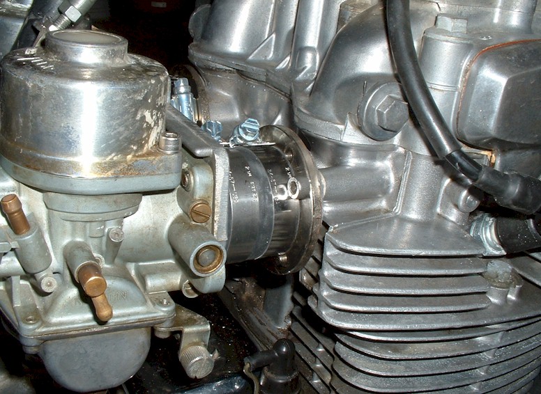

I've made some holders for the piston carbs. Here are the dimensions I came up with.
It's for a 76 S2 and a 75 D2, according to Kawasaki.com.
I then attached the carbs with a section of heater hose. It's ugly, but worked great.
