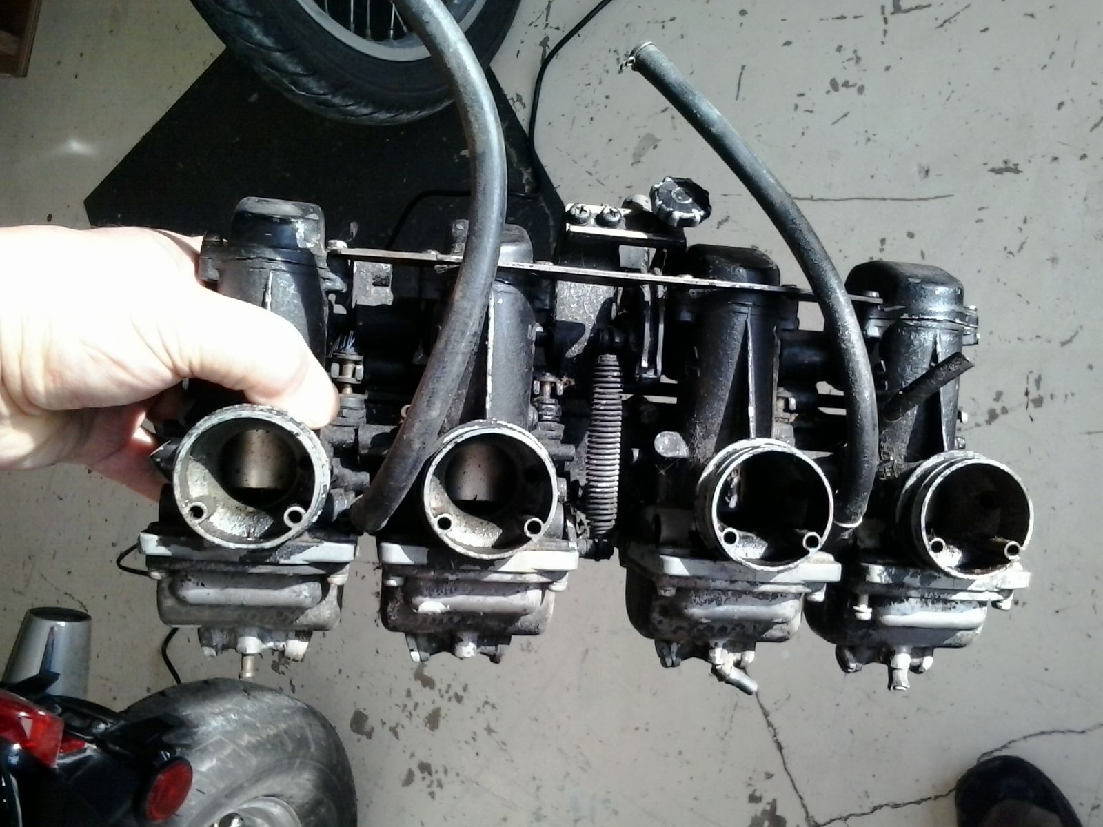

Not that I am looking to derail an old thread but to me it sounds like you have dirty old carbs with clogged circuits.
26 mm carbs on a 77 kz1000 may not be ball buster fast like some of the others but when they are clean and tuned they work great and are "very" reliable.

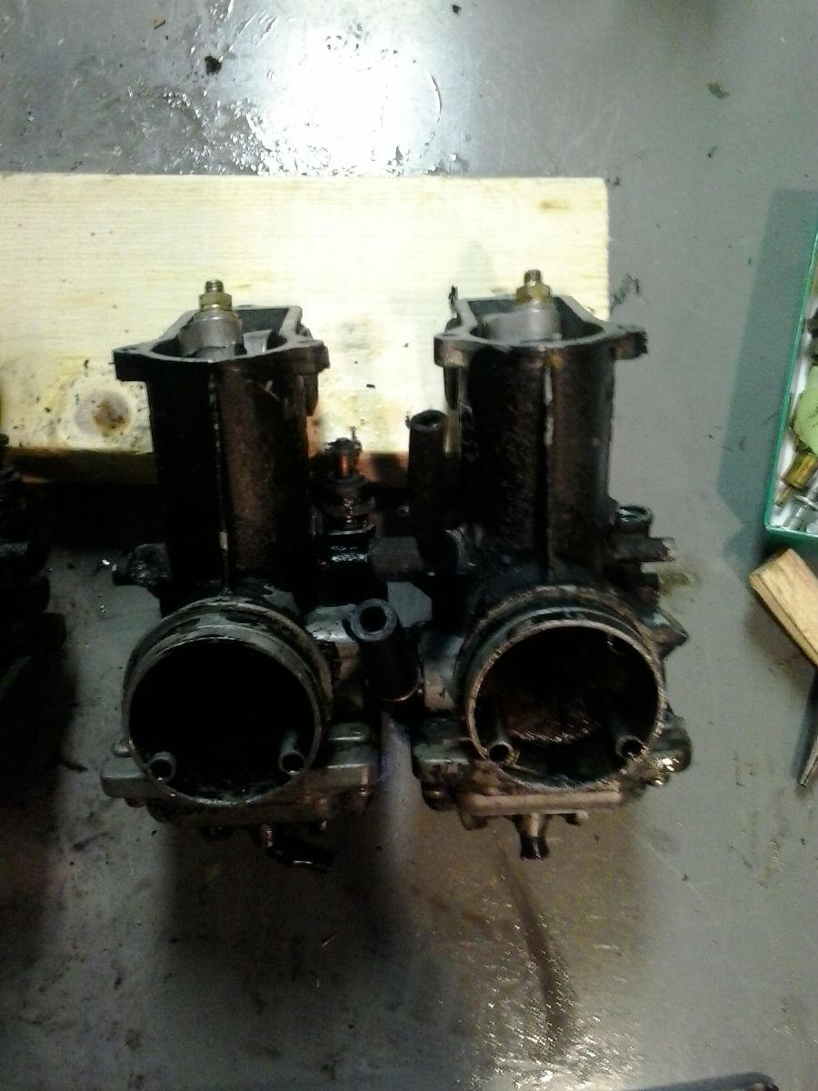

This is the Winter of rebuilding carbs for me, I'm doing a set of 24's and a set of 26's
Both were froze up when I started and the 26's were painted :sick:
Beyond the free labor and cleaners I will need all the gaskets, O-rings and a can of carb dip
