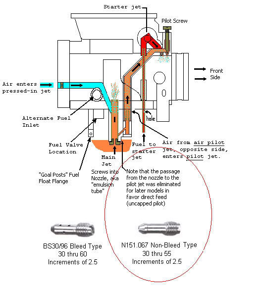

WOW. I'm nut sure why it did that...
Here:
Also... BS34's are really big for a 650. You may have some flat spots/slow speed issues with that big a carb. The colortune is an excellent tool, but your carbs need to be close to utilise it.
The colors you were getting seem to indicate multiple problems. It must be running with the choke closed. Make sure absolutely no air leaks and filter/s installed tight.
Here:
