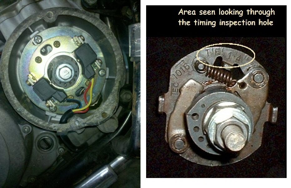

Would lube the "rusty" advancer unit.
Would remove all the clean air paraphernalia (see image below), connect the two then unused cam cover ports to each other, plug/cap all unused vacuum nipples, and plug or tape over exposed hole in air box.
These procedures should help resolve possible issues of a sticking advancer and possible air leak associated with the clean air apparatus.

Here's a pic of the oem ignition introduced on 1979 KZ1000-A3 and D2 models that replaced the earlier points ignition.
Last edit: 08 May 2011 07:57 by Patton.
