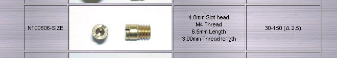

The stock '79 750 definitely comes with Mikuni BS-38. And they use a very tiny size main jet that almost nobody stocks.
The main jets are this size:
N100606-SIZE
and I think you can get them here:
www.allensperformance.co.uk/mikjets.html
If you have Kehnin carbs, I am not sure what jets are in it.
N100606-SIZE

Gotta go with Bountyhunter on that one. Your carbs should be Mikunis. You have the wrong type jet. I decided to try the 130 so I don't have to drill mine out. I'm hoping to adjust the needle clip to compensate for not going up any bigger on the main jet. As for the location of the clip on the needle... pull the top lids off your carbs, remove the diaphram carefully. Turn it upside down and the plastic disc and the needle will fall out. You'll see the circlip on the needle (most likely in the middle slot).
By the way, I ordered my jets from Niche Cycle Supply. Search for N100.606. It will show as a "pilot" jet but it's the right one. They have all different sizes including the 140 that look exactly like the picture Bountyhunter posted below.

that looks exactly like the jet i need!!!
thank big time everyone!!
**yes they say mikuni right in the top..
and thats the jets that fit under the bowl..
i need a 135 of that...now to get it??!!
