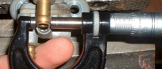

No eBay APP ID and/or Cert ID defined in Kunena configurationNo eBay APP ID and/or Cert ID defined in Kunena configurationI've used automotive type fuel line before but the proper size needed for the carbs falls between the common 1/4" and 5/16" sizes. Either you have to fight with trying to get the smaller size over the nipple or you need a clamp with the larger size. Big pain in the rump if you ask me. Automotive fuel line is also fat and doesn't stretch very well because it contains an inner fiber reinforcement, which we don't need for our bikes.
The OEM fuel hose is 7mm ID (or something very near). I've mentioned this before but the best fuel line I've found is sold by Suzuki (Part# 09352-70103-00B). Order this stuff for about $9 and you get something like 5 feet of the stuff in the package. It's stretchy and thin walled. No need for any clamps to keep it from leaking yet you can push it off easily when removing the fuel tank.
For the overflow lines on the carb floatbowl nipples I bought some 3.5mm fuel tubing from Honda. Great stuff, but a little more pricy. It's worth it though in my view because again, it's thin and you don't need any clamps. Automotive vacuum hose tends to be fatter than necessary.

Could it be that we want part number 09352-70103-00B? That part comes up as a drain hose for water. But maybe it is used for fuel too, as others seem to use it for fuel. EDIT: other suppliers list it as "fuel".
And yes, stay away from any glossy hose. I've tried many, and all failed. Maybe they can work a short while without corn-fuel, but that's almost impossible to get around here.
This comes up as 4.5x8.5x600. What do the numbers mean? if it's ID x OD x length, then is that the right number?Suzuki (Part# 09355-45855-600)
I found it mentioned as a vacuum line.
Quote from this forum: www.thegsresources.com/_forum/archive/index.php/t-216193.html
The vacuum hose part number is 09355-45855-600. Looking at the second half of the number (after the "-"), it tells you that it is 4.5mm inside diameter, 8.5mm outside diameter, probably from vendor #5, and is 600mm long (quite a bit more than you need).
The fuel hose part number is 09352-70103-00B, which tells you that it is 7mm inside, 10mm outside (from vendor #3?). The length is not given in the part number, but I have received about 2 meters (6 feet) of it when I order it.
