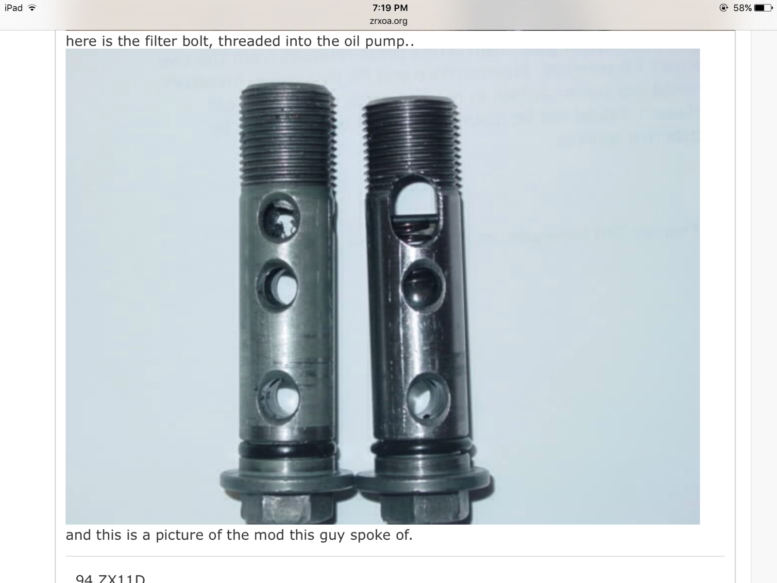

I would be more concerned about the size of the holes and how much oil flows through the new bolt. You can pop that pin out to take the check ball out and bore out the holes if there's any question. I've done it before.
if the threads are nice on the new one, I'd use it.

Here's one I modified for a ZRX. It'll supposedly flow more oil. I cut down the length and elongated the top holes.
