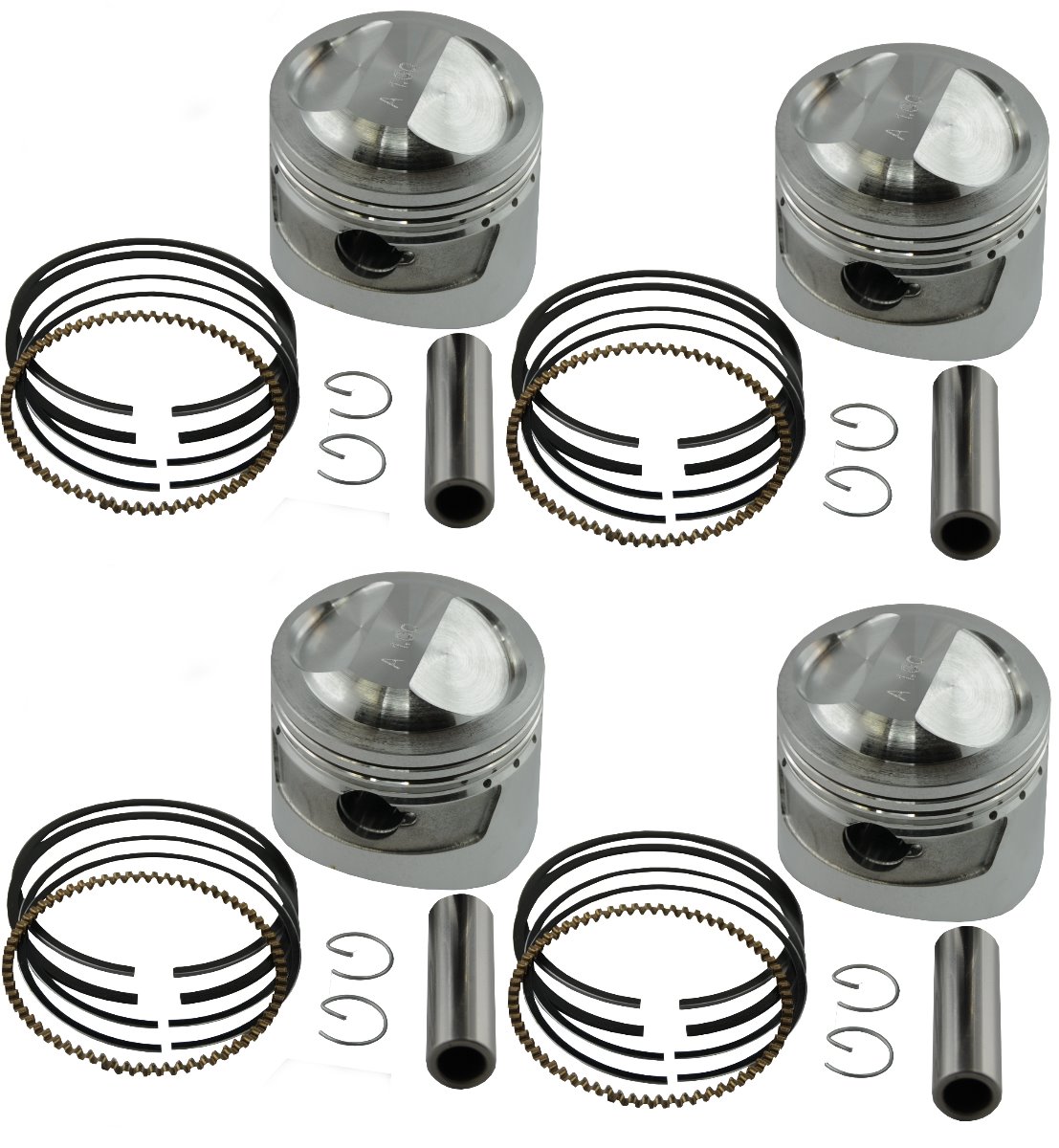

Kawasaki Z1000A Tuning-Piston-Kit 10,5:1 +0.50 mm = 70,50 mm bore size (1030 ccm) for 499 Euro
(you don´t have to pay the German value added tax minus 16 %). So round about 420 Euro plus shipping.
www.scheuerlein-motorentechnik.de/motorr...htung-uebermass-0.50

MTC piston kit ( 1075 is most popular for a good kickin the pants )
