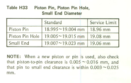

According to the manual the wrist pin to connecting rod fit should be 0.003mm - 0.025mm (KZ750B)
this seems like a very wide range as 0.003mm (0.00012") is nearly a press fit. while 0.025mm (0.00098") is a floating fit. I am going to have the small end of some NOS connecting rods honed so that this tolerance is ideal with the DLC coated wrist pins I have as it is too small right now. What tolerance should I aim for to ensure good oil film? I have read that .0008" is ideal for a floating pin but that was for big V8.
thoughts?
thoughts?

Thanks for the reply. I'm referring to the connecting rod small end and the wrist pin not the piston.

Edit: I'm struggling with math today...
According to those specs the target clearance is between .00011-.0011"
Not sure what to suggest other than go off nominal, say .0007"

0.00011" = 0,002794 mm up to 0.0011" = 0,02794 mm tolerance min. and max. (not Service Limit)
nominal, say 0.0007" = 0,01778 mm so what´s wrong with the math?

Should aim to be in the middle of the piston to rod range then? (.025-.003)/2+.003= .014mm (.00055")
