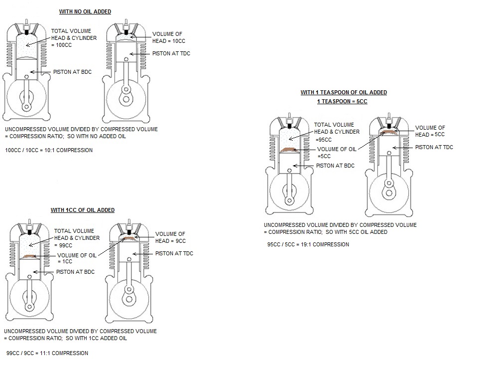

The issue I have with just putting oil in the cylinder is that even if the rings and cylinder are perfect it will still raise the compression. The images below, which assume a perfect seal between the rings and cylinder wall, show what I mean. Even with perfect rings and cylinder walls the compression will rise if oil is added. Please don't misunderstand - his problem may very well be with rings or cylinder wall condition, but a leak down test will show if there are other issues that should be addressed. Ed

27 Mar 2020 12:11 - 27 Mar 2020 14:20zed1015 wrote: He has put oil down the bore which increased compression and that is a strong indicator of ring or bore issues.
If it was bent or sticking valves there would not be an improvement.
This is very good point, but pouring oil into a cylinder with a perfectly good piston/bore and rings will also lead to an increase in compression as it plugs the ring gaps.
So in theory he may have boosted that cylinders pressure making ability by plugging the ring gaps with oil (raising compression) all the while compression was escaping through a leaking valve. Even with oil he still was 20 psi away from the other cylinders. Hence the leak down test will confirm if he has a broken ring or a melted piston. Or maybe it’s just carbon baked onto a valve seat.
