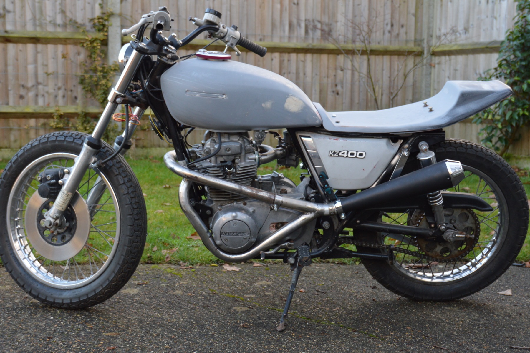

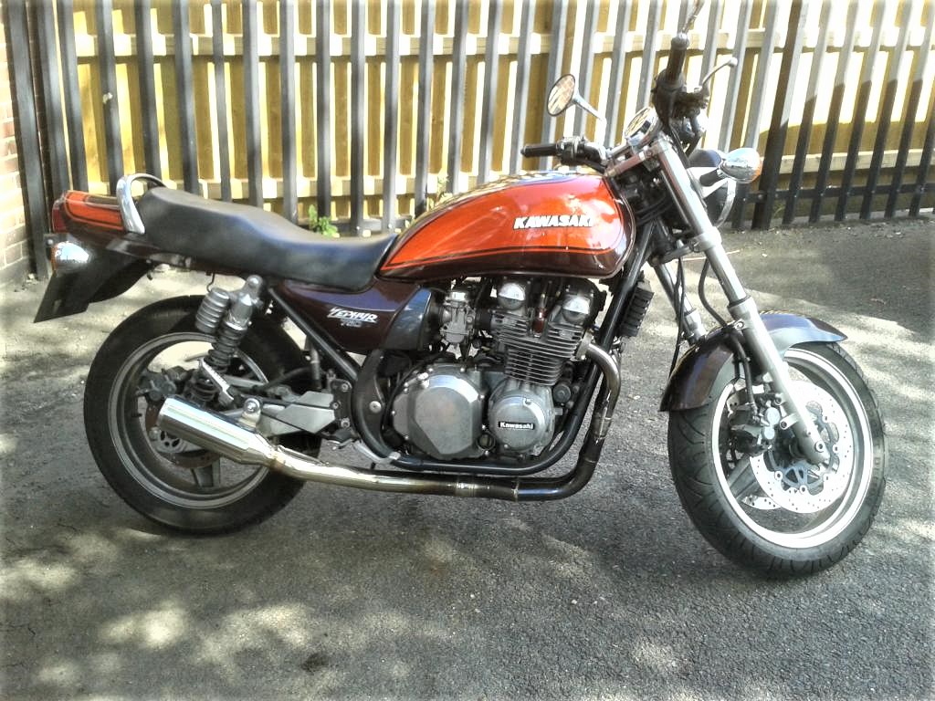

luckily the headers i have are one piece with the 4 into1 colector welded to them so i only!! have to make the silencer! are there any basanni owners out there good enough to give me some rough dimensions of the tail pipe? to help out a cheapskate armed only with a mig weder and grinder. i mde these acople of years ago out of odds and sods of headers and various bends by slicing and weding and plenty of filing and grinding

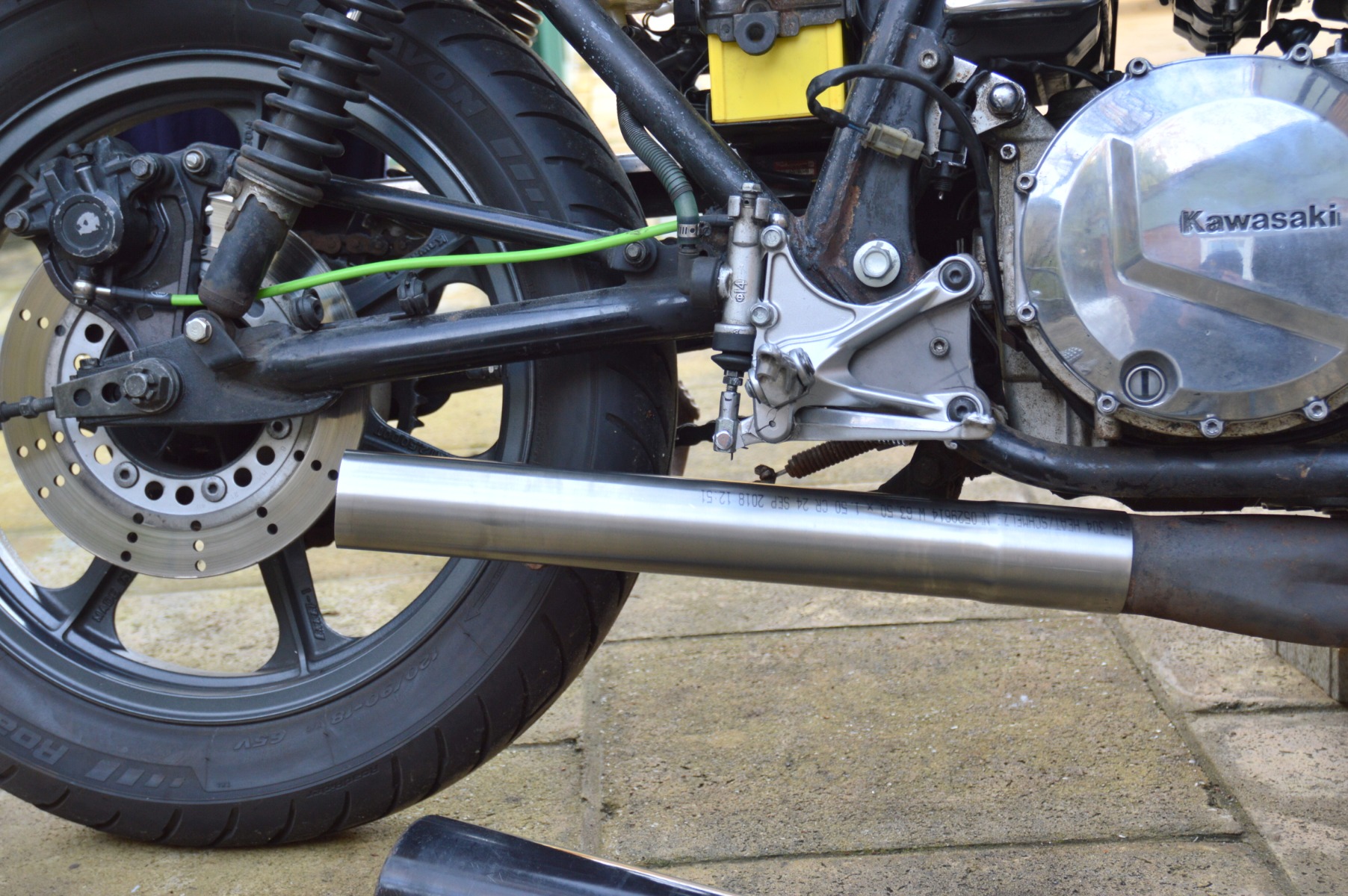

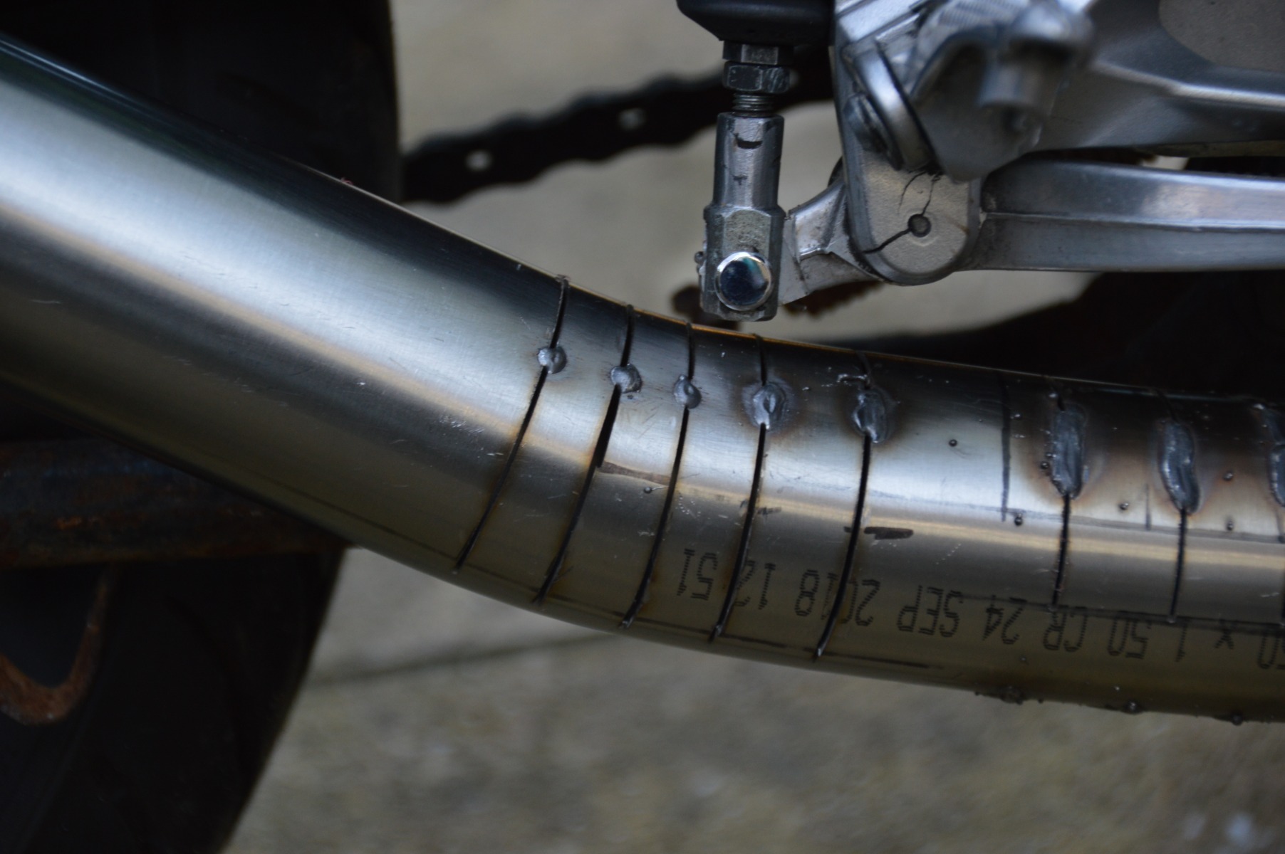

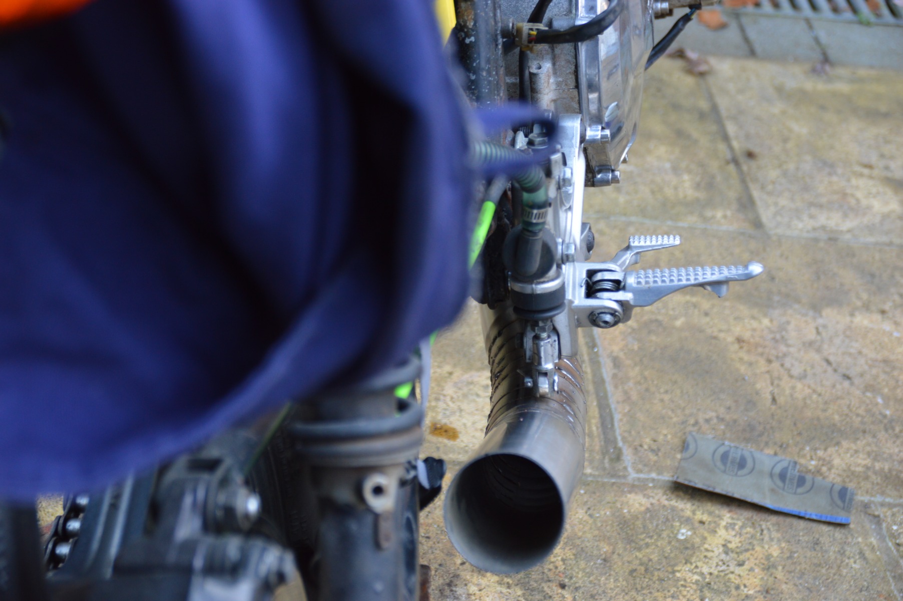

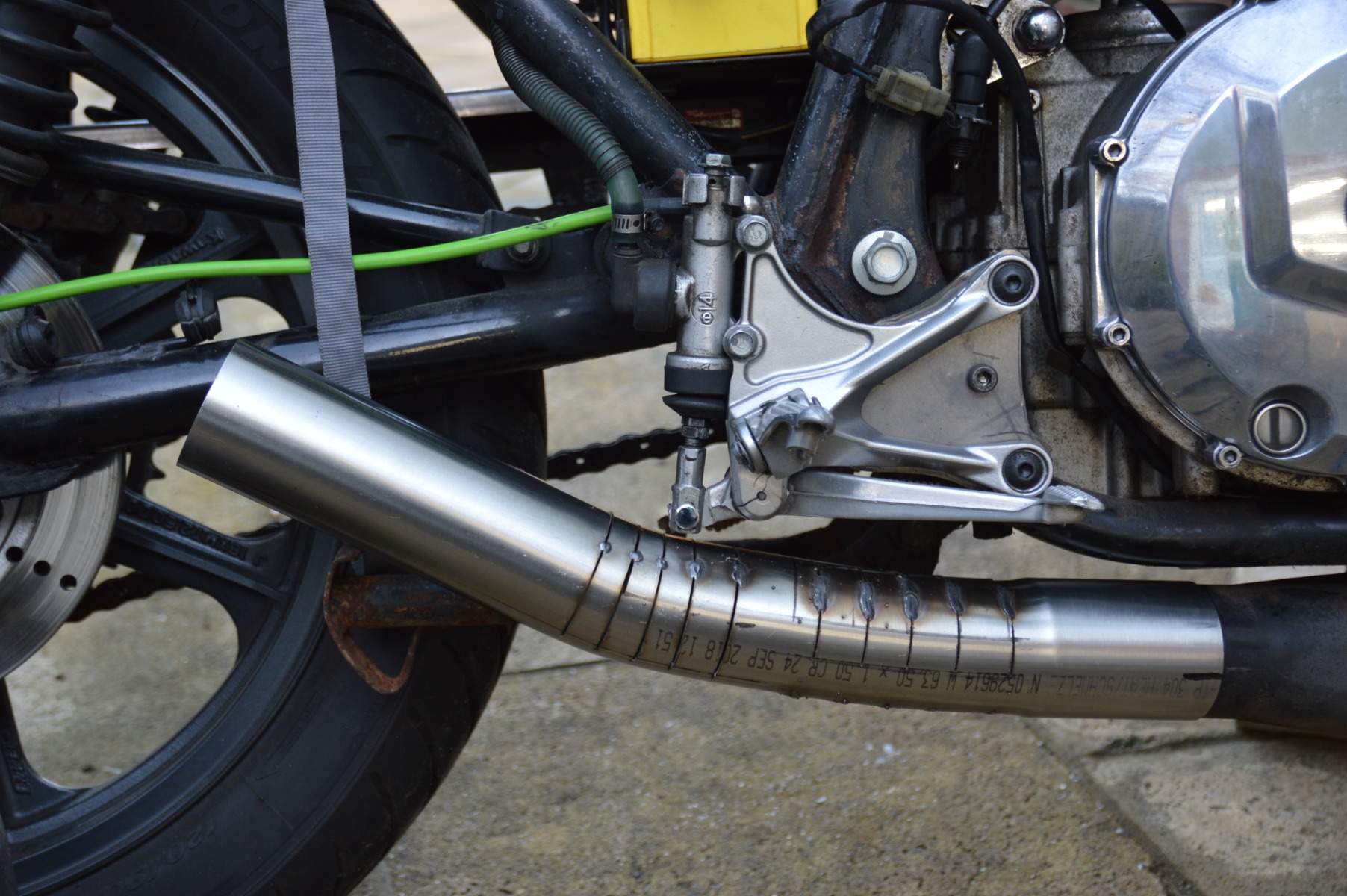

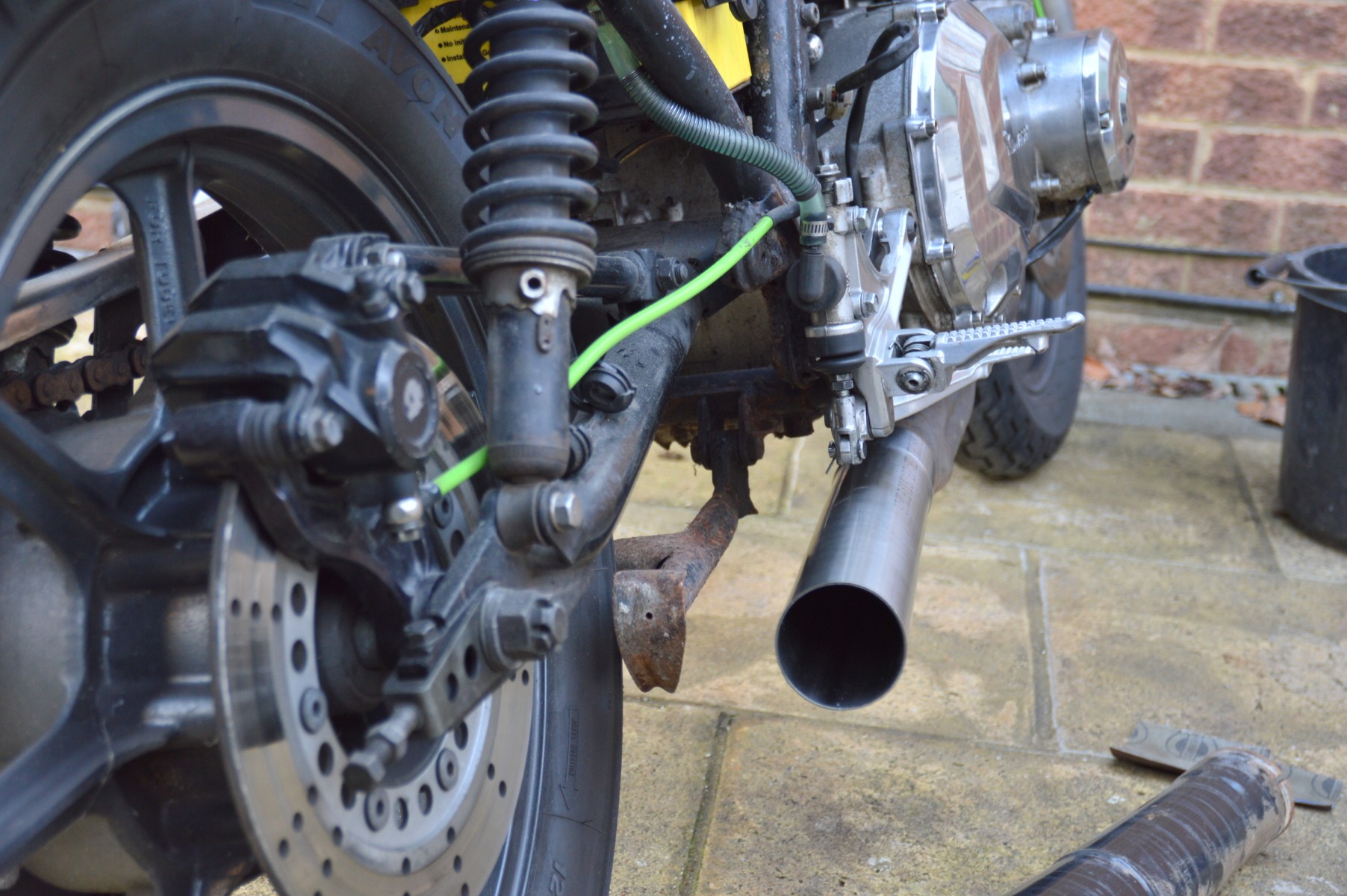

made a start on the pipe purchased some 304 stainless tubing in 2 1/2 and 3 1/2 inch and a couple of cones. due to the lack of tools this is the way i have done.it im sure there is an easier way and im sure that some may appaled but my method but its cheap and might just work!! tools involved 4 inch grinder with 1.5mm cutting disc a tape, sharpie pen and mig welder with 316 stainless wire. cut slits in pipe about 3/4 of the way round and bend keep cutting slivers out until desired bend is reached tack . i then ran the disc through the slit to open it up so the weld has somewhere to go 2/1/2 pipe before cut and bend
a bit of cutting later
a bit of detail of the cuts roughly 20-30 mm apart seems to give a smothish curve. before and after
tailpipe hopefully at the weekend i will post pics if anyone is interested after the first lot of bodgery!!
