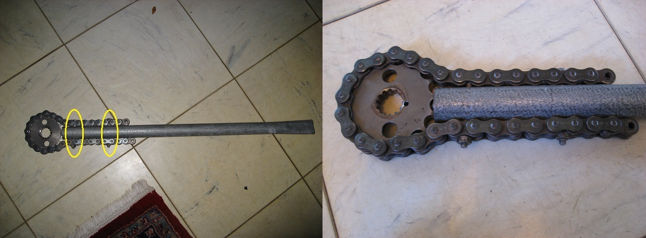

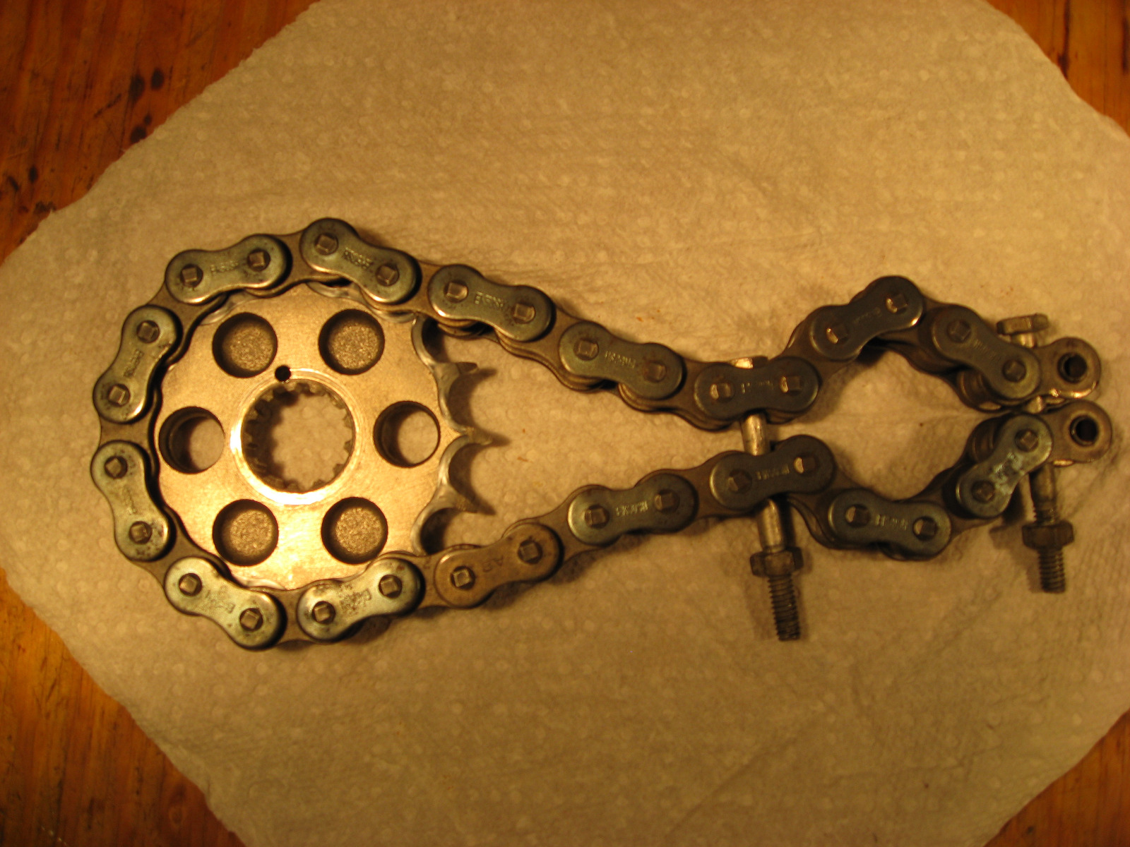

The photos in my reply above were lost, so here they are again.
"These two methods? The first shows with engine in frame the second if the engine is out of frame. Ed"

Thanks for the pics and helpful information. I ended up going with the chain and grade 8 bolts with a piece of steel in between tightened down with nuts. WORKED! you realllllly need to have the sprocket completely motionless so that you can get maximum torque. I finally got my nut off. I'm a real boy.

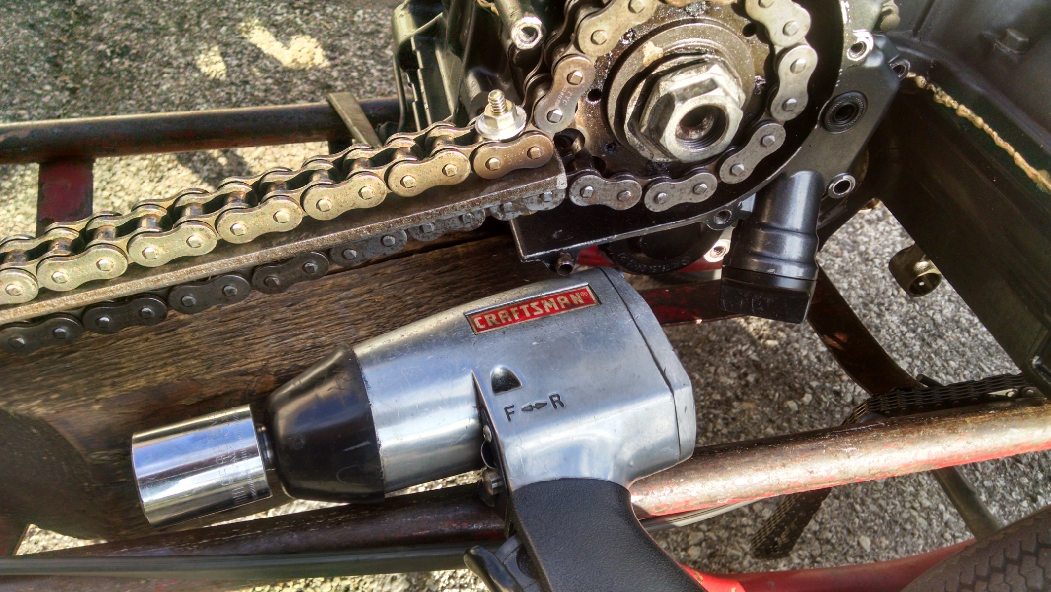

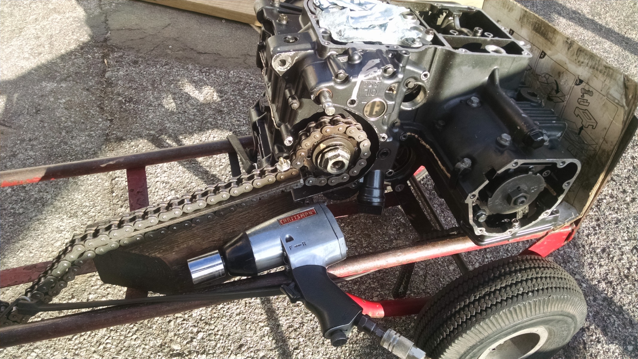

That's great! It really does need to be locked up solid tight. I prefer to use the impact over a long bar because the impact is a short blip of massive torque compared to a steady pull from a breaker bar and cheater bar that would be more likely to break something off. The rubber sprocket damper counteracts the impact hammering pulses. In case no one noticed, my engine pictured is upside down on a 2 wheeled dolly. (the PO removed the engine)
