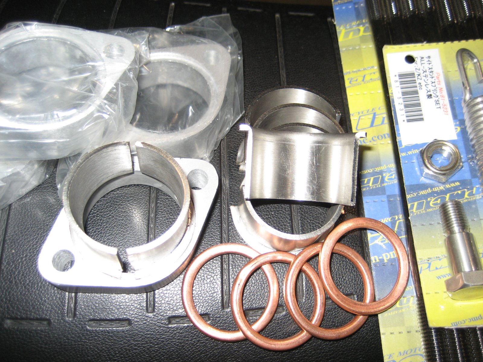

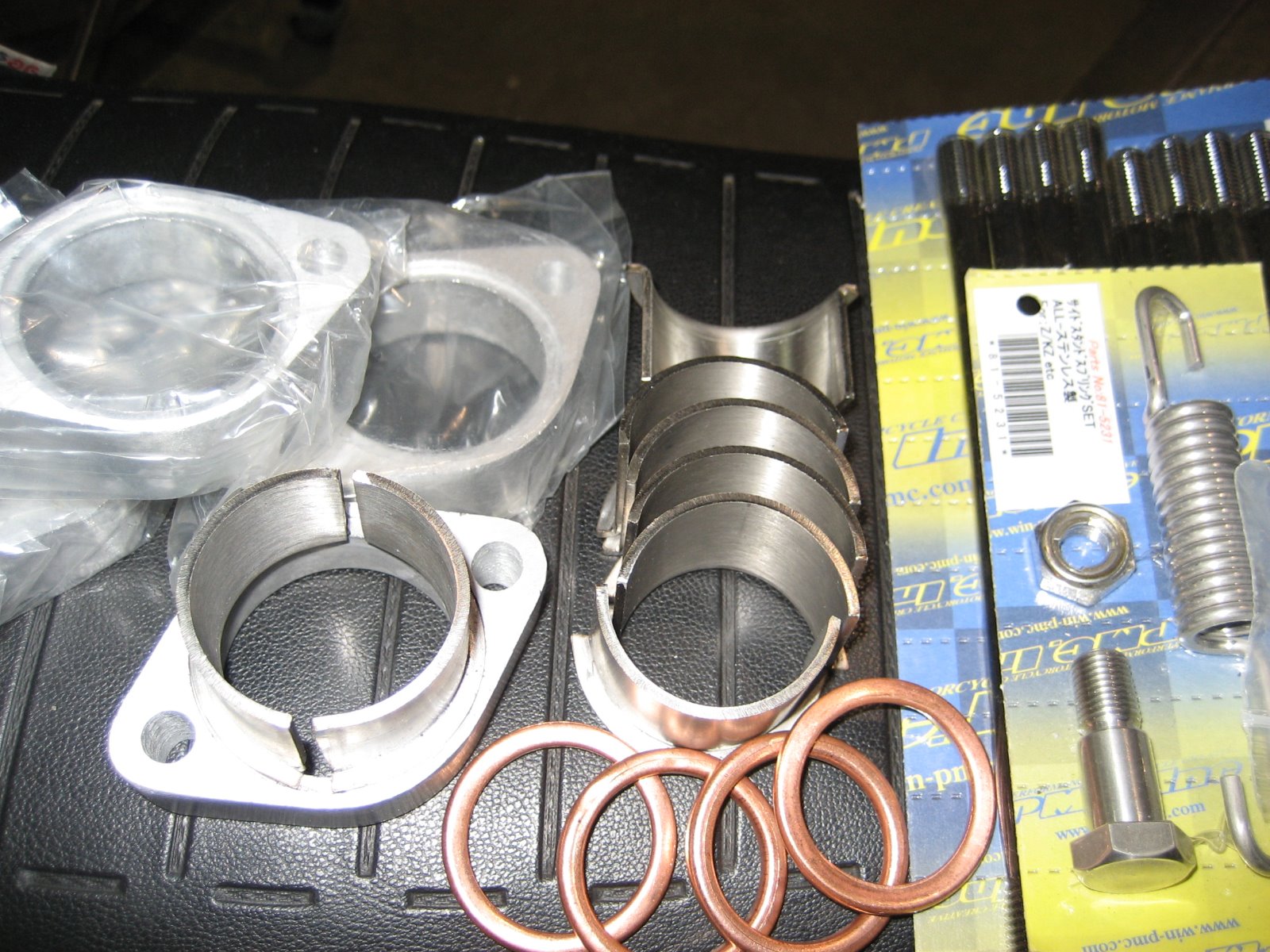

Maybe you need longer half split collas, my collas were made from stainless steel
[ attachment=124730]IMG_2487.JPG[/attachment]
Yours look like late shorter GPZ half split collas like Nessim

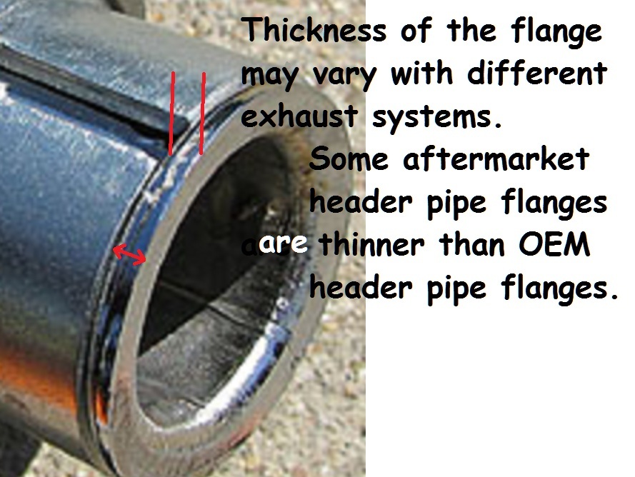

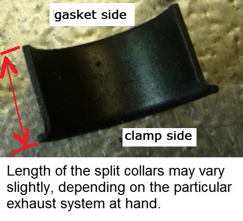

Am presupposing that the pipe flanges align with the exhaust ports, but that the pipes won't tighten into position because the split collars at hand are either too wide or too narrow.
Is there some other fitment issue besides width of the split collars?
Correct split collar width will properly compress the gasket just as the clamp meets the head when tightening the nuts onto the studs.
