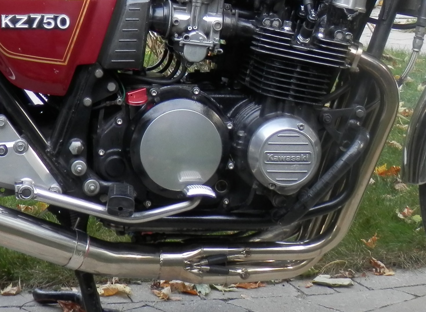

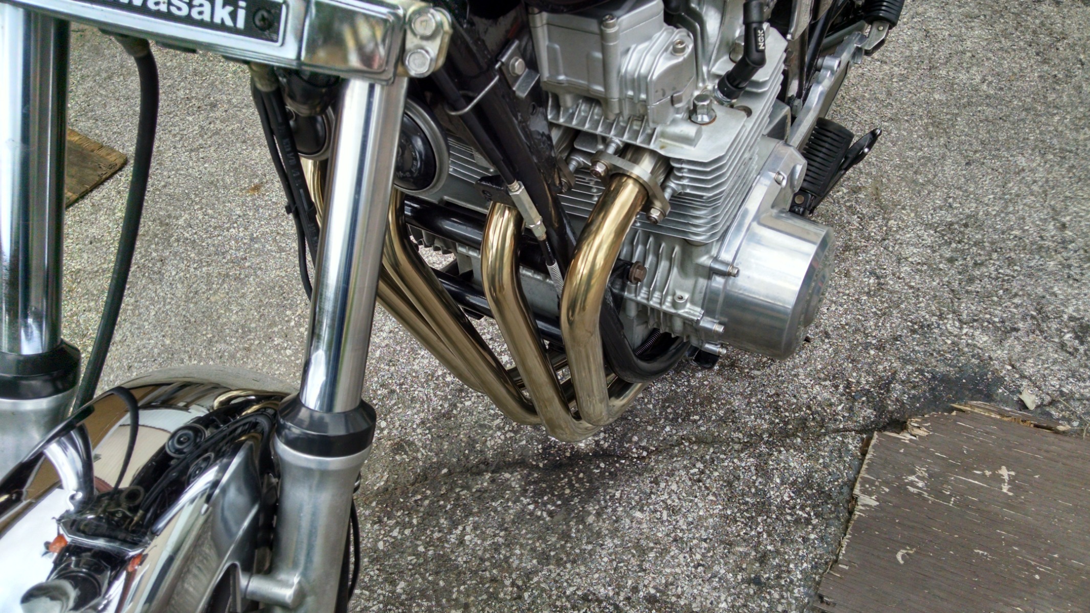

Gold color. I think that's what stainless steel pipes do, turn gold. The ZR7/ZR7S models from the early 2000s had a ss muffler system & just about every one of them I've seen has a golden hue. Here's a pic of Andy-the-Gringo's KZ650 w ZR-7 exhaust.

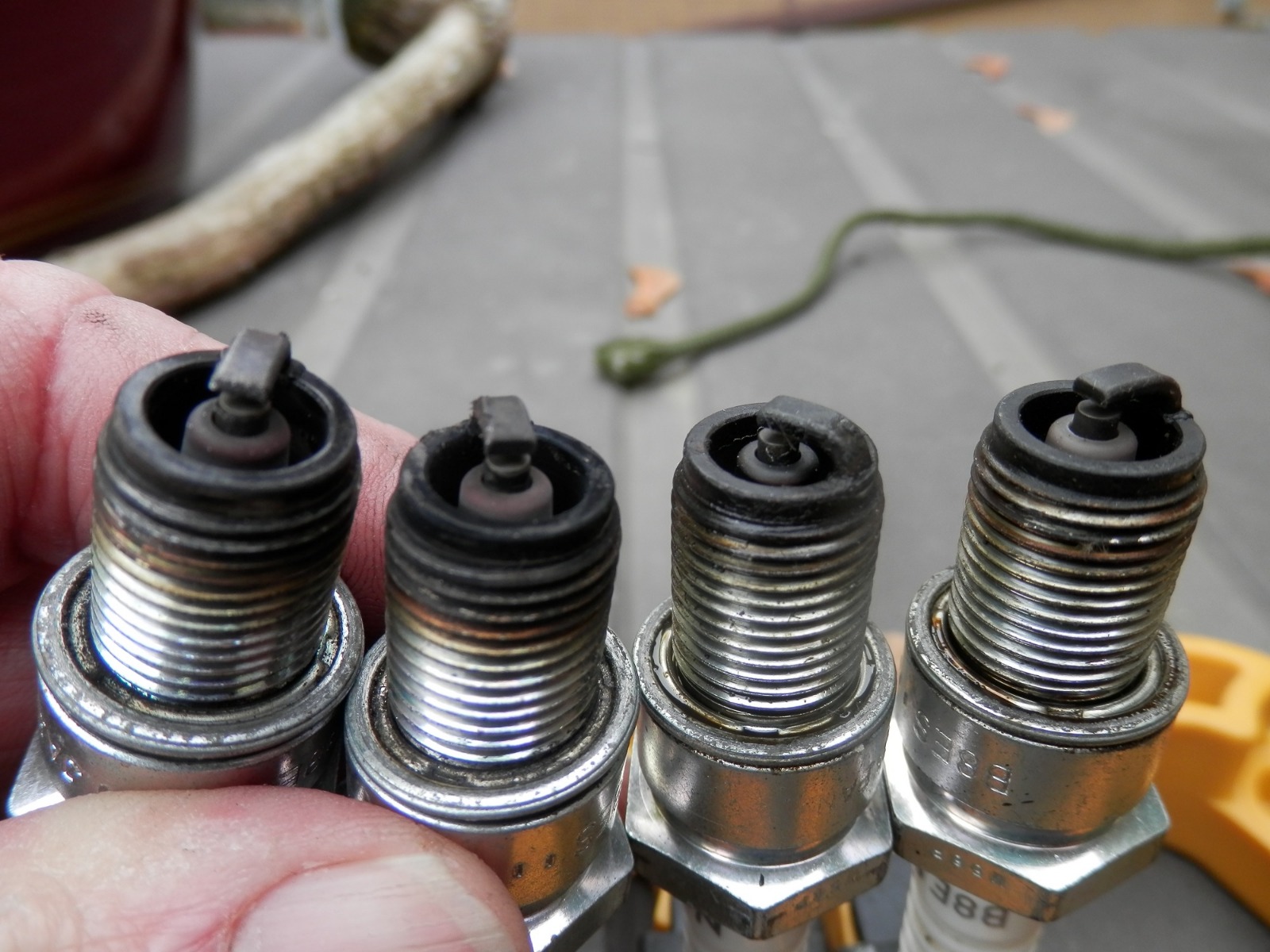

I have a touch of blue on my Delkevic header at the engine and suspect mixture is a tad rich ( (better rich than lean). It has been this way since 2017 and I am not concerned.
Most BMW flat /opposed twin airheads have SS headers that are quite blue and some people dig the blue. I haven't noticed the collector but checking will have to wait until our snow melts and things warm up.
Plug pic summer 2018
