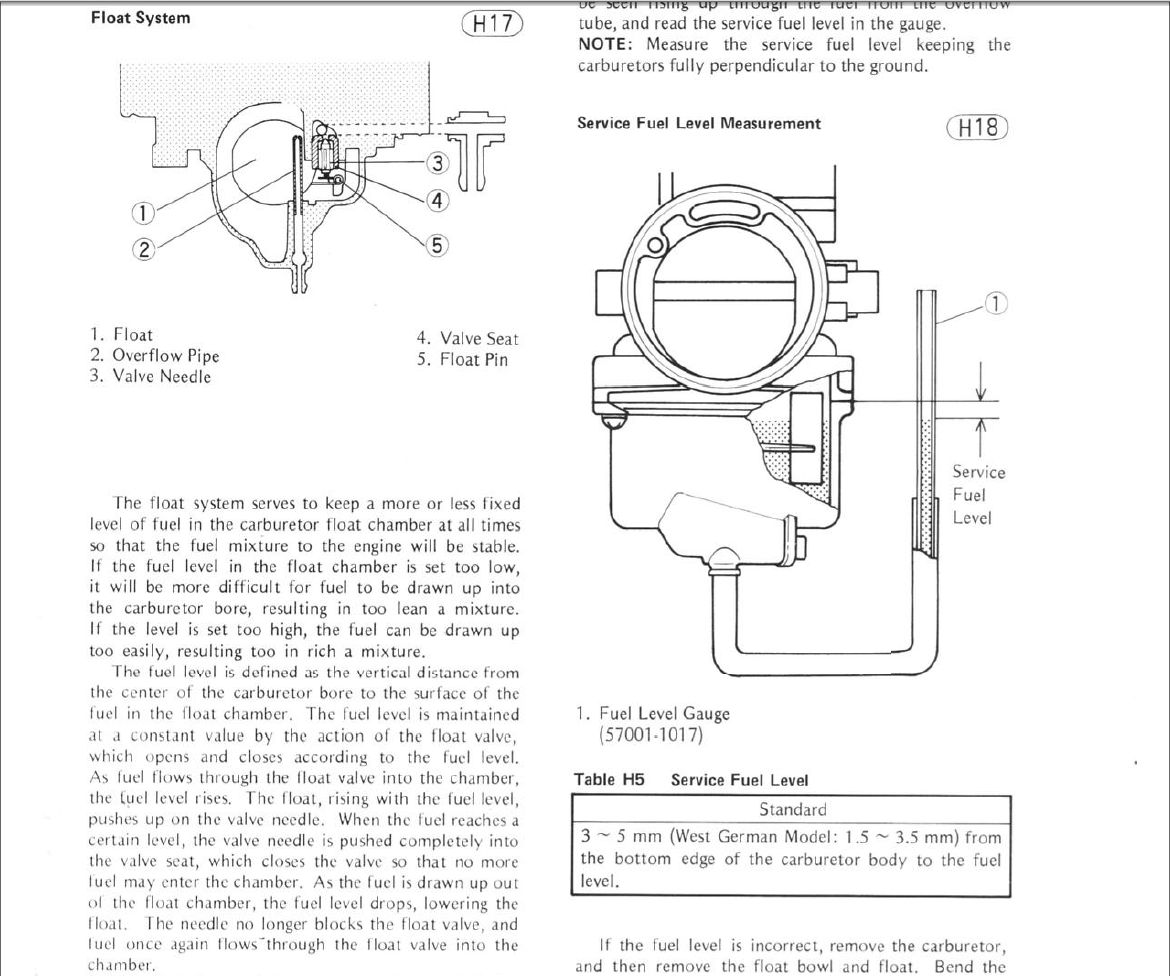

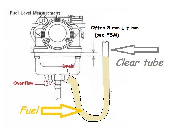

Much easier and accurate measure height when the carb is mounted on the engine, see attached photo.
