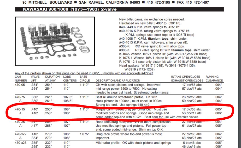

The Megacycle catalog I found says the 470-15 .410 lift cams need new springs and modified pistons. Seems similar as APE. The APE cams have more duration too so that brings in more possible valve to piston contact.

You sir are correct on that aspect. I was actually looking at the other listing on page 47 for the gpz1100/ 1000 j. I checked part numbers and my 82 1100 a has the same piston as an 82 gpz1100 so i figured thats what i should be looking at. same bore and stroke and everything just one is chain and one is shafty. am I wrong in thinking this?

I couldn't believe MegaCycle would have stated that stock pistons and springs would be OK with .410 lift. Glad to see that was clarified.
You need to consider that the overlap in longer duration cams will lower cylinder pressure, so higher compression pistons will restore that. Our .410 work fine with shim on top.. People have run .418 lift with top shims and experienced a clicking sound. Upon close examination, it was the shims lifting up then going back down. Way too risky as far as we are concerned.
