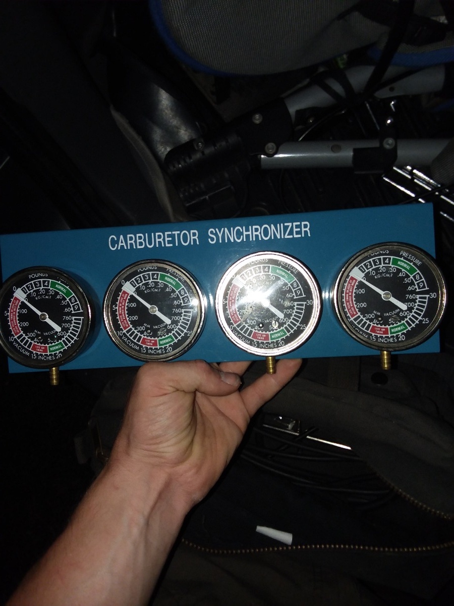

Finally found someone with a carburetor sync set that they let me borrow to balance my carbs. I noticed that the vacuum ports on the engine carb boots do not unscrew to put the metal straws that slow the needle bouncing around into the carb boots. So I tried using a little piece of vac line on the threaded side to connect it to the ports which slowed the bouncing down. But I noticed that every gauge was in the "late valve timing or vac leax" on the left side of the set I'm using. I set the carbs to at least all be even as possible but I noticed that the idle at neutral rpm is supposed to be 1000 but if I try to set it there the bike will run like its about to die and sometimes will. But after I made the adjustments the bike ran fine for about a day or 2 then one morning it was really struggling to stay running. It died while I was coasting down the hill I live on then I had to leave the choke half on for about half my 15 min trip to work. And now it will run without choke if I keep it at at least 2 rpm but when I take off unless I baby the clutch it almost dies. It has a super "throaty" sound now and I'm getting a crackle between gears and lots of popping when coming down on rpms. Sorry I'm always posting new topics but I just keep having issues and this is my first bike lol. If anyone can give me ideas of what to look at that would be great thank you as always!

After the engine is warm, I would set the idle to about 1200 rpms. When the motorcycle & tachometer were new, 1000 rpms would be expected, but the bike & tach are now 35+ yrs old. In regards to the valves & timing, two things you should do are the valve clearance check & timing advancer service. You could check the timing with a strobe light.
Valve clearance. Doing the check is fairly straightforward. adjusting the valves is more work but should be doable as many a first timer have done it. I've checked the clearances but haven't had to do the adjustment yet.
Timing advancer. Clean, check & lubricate the timing advancer. Separate the rotor from the advancer body & fill the groove with grease & apply grease to the springs & pivot points. Inspect it, especially the springs, & operate it to make sure the rotor snaps back. Re-install & tighten the advancer bolt to the correct torqe spec. When doing the valves, do not use the advancer bolt to turn the crankshaft.

I have to replace the cam end plugs and got a lot that has the plugs and a new valve cover gasket, would I be able to check it while I have the cover off? Or is there something else I have to do and I will have to get some feeler gauges I know that. I also had to install a Dyna S ignition, would this have any effect on the timing advancer? When I installed the Dyna I got the timing as close as possible but I remember that there was something off just not exactly what it was. Also what type of grease should I use? I work on aircraft and we have I believe Mobil brand general aviation grease would that work?

I do believe this is high temp but I'll look as it is decently thick. But however the weirdest thing happened.. I was on my way home from getting feeler gauges and I took off accelerating faster than usual then BOOM the bike kicked back to it's normal power and sounded much better. Still have the excessive crackling and popping but it is much better now. So I took the long way home trying to see if it'd go back to the bogging like before but it did fine the rest of the way. When I got home I set the rpms to about 1.2 like you said and you can defiantly tell something is off the idle didn't sound steady at all. Will look into valve clearance this weekend now that I have feeler gauges. Will the ones I got work? .0015in(.038mm) through .035in(.889mm) 32 blade set
