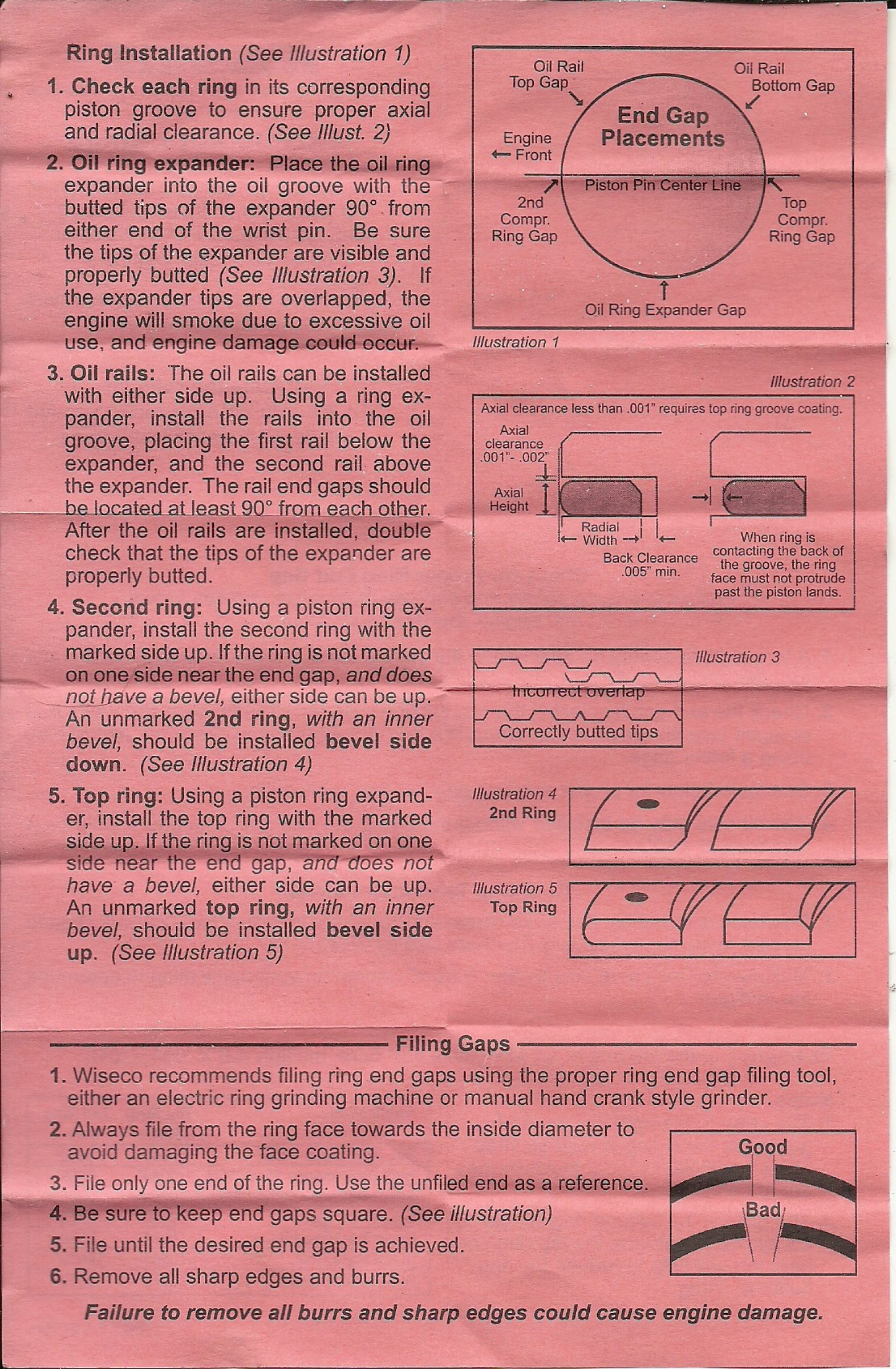

Yeah im not red lining the bike revving it constantly, i just couldn't figure out where i was losing oil until i noticed my axle nut was all black and sooty so i gave the throttle a few quick 3/4 throttle revs and could finally see some smoke as the bike returns to idle.
Ill spend the $$ and just replace all the necessary gaskets for piece of mind.
Ill see if i can get cylinder #4 at TDC tonight and double check its oil...although I'm pretty sure it is. I haven't ridden the bike in over a month and it still looks shiny and wet, if it were gas i would assume it would evaporate and leave a normal dull finished top of the piston. And considering im losing so much oil, no matter what i need to pull it apart so it doesn't really matter right?
And as for the ring installation sheets, i followed all the instructions in my manual and did set up the oil rings at 90 degrees apart from one another on every cylinder and my manual has the compression rings at 180 degrees from each ring gap but the manual has one facing forward and one to the rear rather than one left and one right but i dont think thats an issue as long as they're 180 apart.

If you look at the oil ring spacer you can see one is overlapped. That is wrong but a common mistake. That's why I posted it. If you're lucky, that's your problem.
Good luck.

I had new Wiseco rings and pistons installed by a reputable dealer when I was young, my bike used oil and smoked under hard acceleration, the culprits were the second piston rings fitted upside down.
You should just make out a small taper on the ring face of the second ring.
