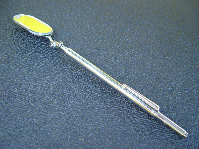

I use a telescopic mirror
The following user(s) said Thank You: theApehouse
- theApehouse
- Posts: 41
- Thanks: 11
Re: is your centerstand really level, for oil check?
18 Apr 2016 18:469er rider wrote: I use a telescopic mirror
Holy smokes.. How did I not think of that?? Awesome! So no center-stand for you, you just sit on it and check level via the telescopic mirror?

Patton wrote: Here's an easy way to check oil level when there's no centerstand or assistant to hold the bike balanced upright.
While sitting astride the bike, use an inexpensive pocket style telescoping mirror to see the oil level through the sight glass. Such mirrors are readily available from almost anywhere automotive tools are sold.
No precariously trying to hold the bike steady and level while squatted down and bent over or on your knees beside the bike.
Works even better with a flashlight or worklight on the floor with beam directed at the sight glass.
Patton wrote:
Absent center-stand, and without a sober helper near by, with cold engine, can sit on the bike to hold it level, and use a telescoping mirror to view the oil level. I prefer this to kneeling or squatting down beside the bike and attempting to hold it steady, level and upright while viewing the oil window, which risks losing control and allowing the bike to fall over, even when cold sober.
These very inexpensive mirrors are readily available at automotive supply stores such as Auto-Zone.
