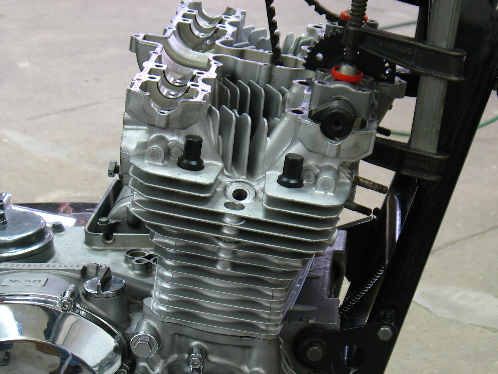

It is a problem when working with high lift camshafts and heavy springs that require more frequent service and SOB buckets, no training course or service manual is going to change that.
Not to mention the threads in a 30-40 year old head that is being used for something it was never designed for have often already been compromised or destroyed by less than skilled mechanics. Add to that the fact that properly repairing the threads with an insert (not those problematic helicoils) is difficult if not impossible with the head/engine in the chassis.
Yes there is a certain installation sequence, no that doesn't solve the problem when working with non-stock components and threads that may already be suspect. I have a little bit of experience myself and IMHO the cam cap threads in Kawasaki cylinder heads do need special attention. Why put unnecessary wear on a thread that's difficult to repair, to each his own.
One of the threads in the ported GPZ head below was damaged (not by me) but I managed to salvage it by bottom tapping the hole and using a stud. I'll have to properly repair it the next time the head is off. Bathtub heads are getting more expensive and harder to find.
