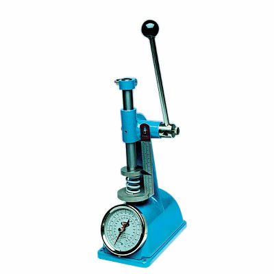

Yes you are correct!! Take the springs to any engine shop that does valve work and ask them to test them for you just as the manual suggests... or buy five new ones. Probably cost about the same unless you know someone with a bench, valve spring tension tester.
contentinfo.autozone.com/znetcs/product-...US/com/5313/image/4/
I may be wrong, but I'm under the impression that the test described in the manual (see my previous posting) tests the spring when it is partially compressed rather than at its free length."

One of those spring testers would be great to have but they are very pricey. I have a box of springs that are either stock KZ, some H2 and an assortment of lock-up and slider springs. Knowing what each spring tension is would help in setting up clutch and knowing what a stock spring should be would be a good way to keep tabs on any clutch if ever an issue arises. Have a proform spring tester that is used in a vise but I think the guage would be to stiff for a clutch spring considering it was meant for valve springs. I'll have to see if I can find another guage that goes to 100# or so.....
