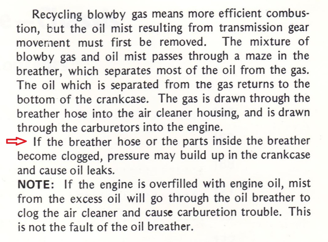

Check that vent tube to make sure it is not crimped or blocked in any way.

Hmm now that you mention that, it seems to me that the smoking problem started the day after i ran a piece of hose from the crank vent to down over the swingarm. But from what i can tell its not crimped or restricted in any way. Also, i can feel a small amount of air coming out with the bike idling. What could this vent have to do with it burning oil? My understanding is that vent only lets excess pressure out of the crankcases.

04 May 2014 02:51Kawilk01 wrote: Hmm now that you mention that, it seems to me that the smoking problem started the day after i ran a piece of hose from the crank vent to down over the swingarm. But from what i can tell its not crimped or restricted in any way. Also, i can feel a small amount of air coming out with the bike idling. What could this vent have to do with it burning oil? My understanding is that vent only lets excess pressure out of the crankcases.
