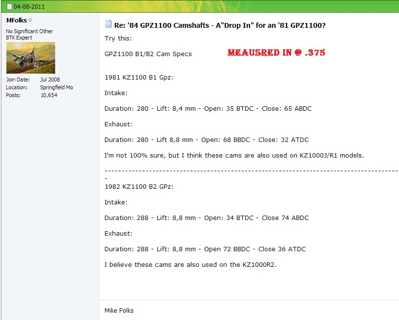

Took Larry's advice on those GPZ cams... they rock absolutely LUV them...
Sweet low to mid range to 3/4 throttle performance!
NOTE 1: I believe mine where 1983 cams and they did not have the tac threads...
Dial caliper measured in @ .375 lift, unknown duration for OEM spec sheets hard to find....
NOTE 2: CAM Sprockets, 2 bolt only, can obtain the sprockets at APE.
NOTE 3: Cam degree for 108 on the intakes, 106 on the exhaust.
Non J head pre 1980 as in my '78 KZ1000 head, yup have to clear the bucket journals...
Can't say for J head or other outside of pre '80 kz head, follow others advice.
via Mfolks... Thanks Mike!
