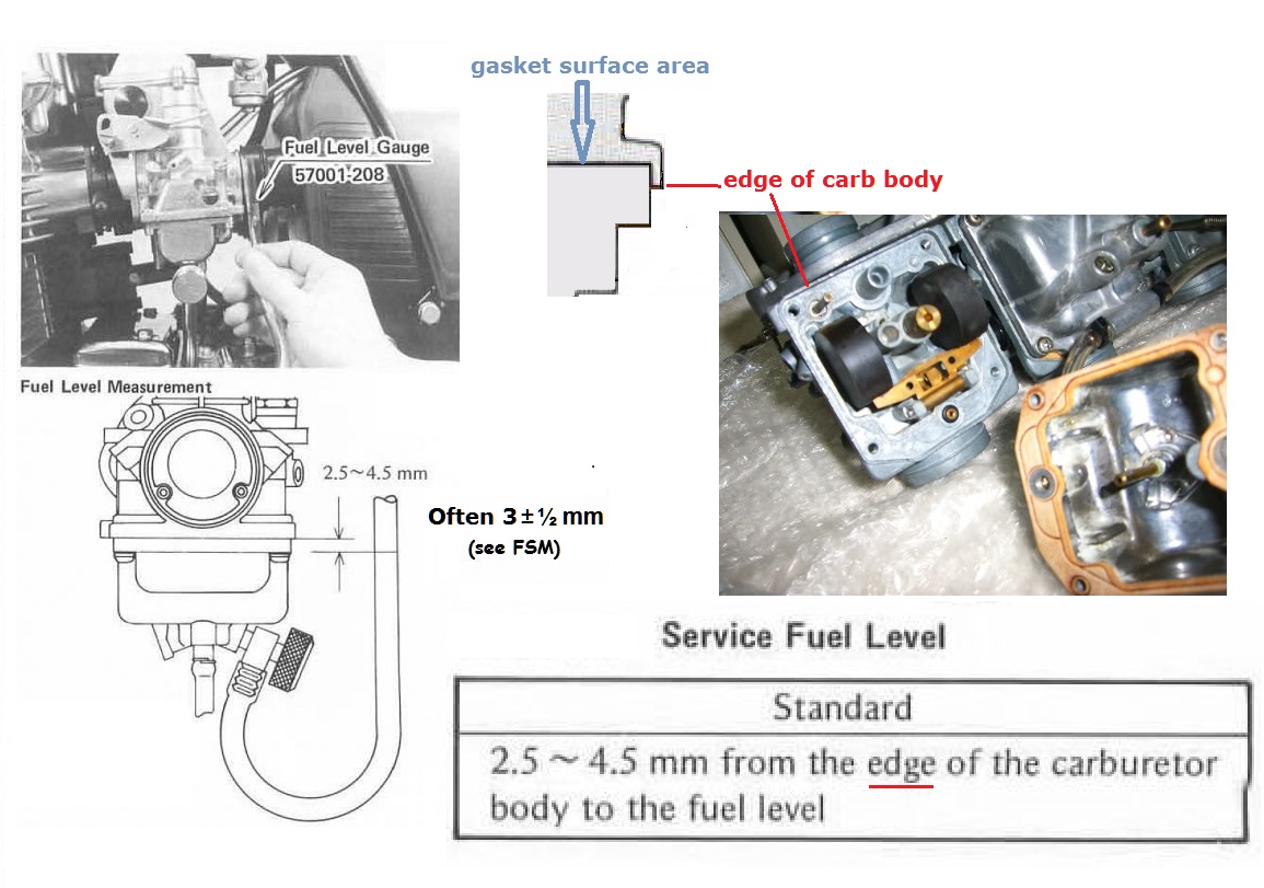

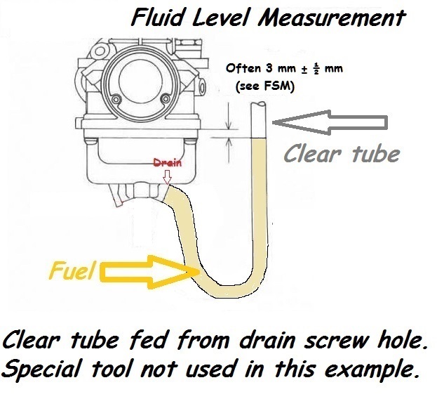

The carb is designed to best perform with a certain specified level of fuel inside the float bowl.
A too high fuel level results in an excessively rich mixture throughout the throttle range.
A too low fuel level results in an excessively lean mixture throughout the throttle range.
The objective of the CLEAR TUBE TEST is to determine height of fuel level inside the float bowl.
When the test is performed correctly, the level of gasoline visible inside the tube will match the level inside the float bowl.
Carb must remain in a stable level position during the test, such as motorcycle on centerstand or otherwise held steady in a balanced level position. Or carbs may be held level on the workbench.
First -- prevent gasoline supply to the carb, and then drain the float bowl.
Which leaves an empty carb with a dry float bowl.
Next, attach the clear tube and hold it steady alongside the carb.
Then, allow gasoline to enter the carb.
The incoming gasoline passes through the float valve and into the float bowl.
As the level of gasoline rises inside the float bowl, the level of gasoline also rises inside the clear tube.
If the float valve is correctly functioning, the float will rise high enough to close the float valve, at which time gasoline stops entering the float bowl, and remains at a fixed level inside the float bowl and at the matching level visible inside the clear tube (either too high or too low or within specs).
Learning the actual fuel level inside the float bowl completes the clear tube test.
If the fuel level is too high or too low, "adjusting" the fuel level is a separate procedure, which involves changing how soon the rising float stops gasoline flow through the float valve.
