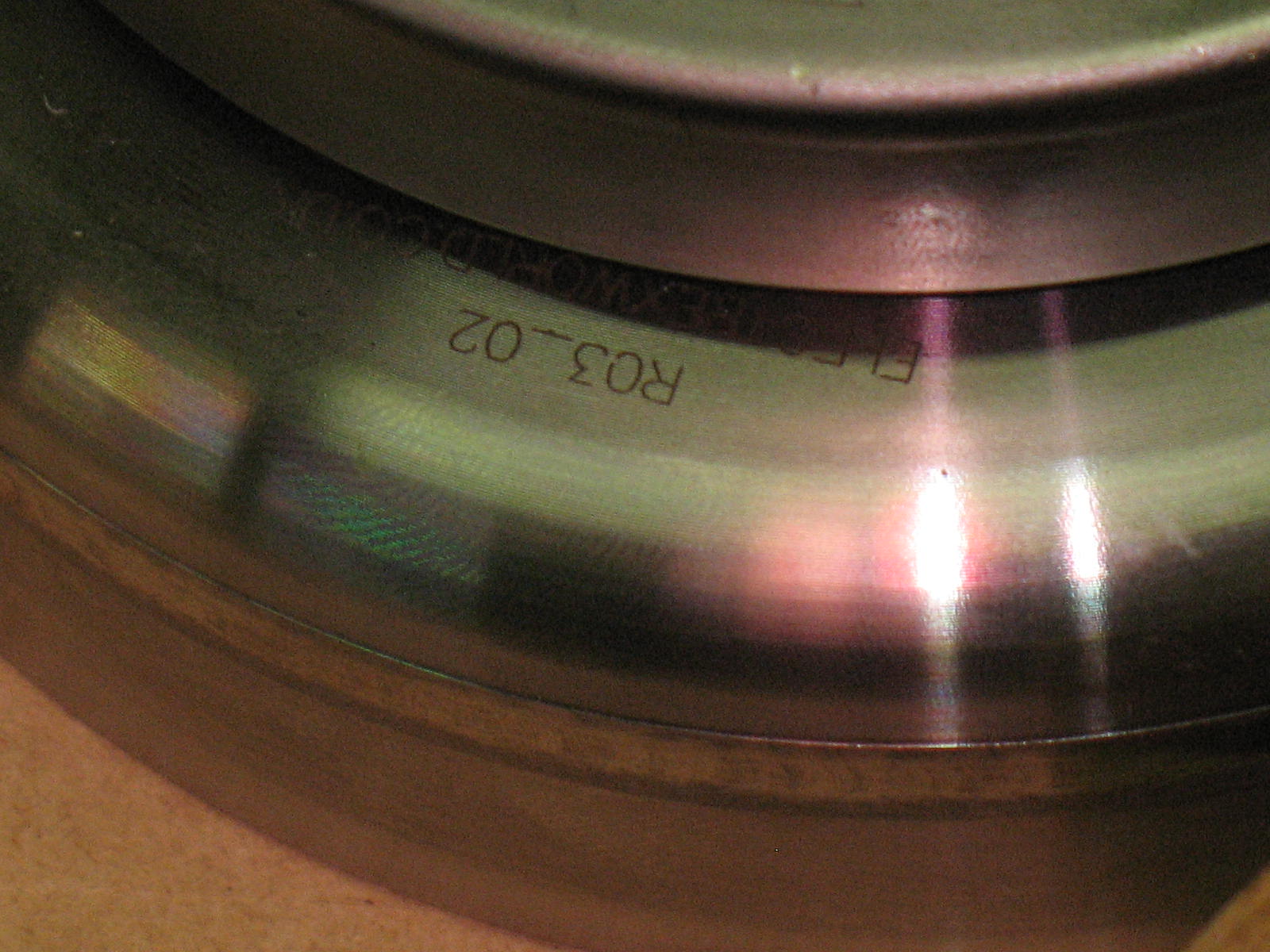

If you go this route, plan on spending some time scratching your head when installing it. I would suggest you request the RO3-O2 (newer unit).
Here is a picture what it looks like.

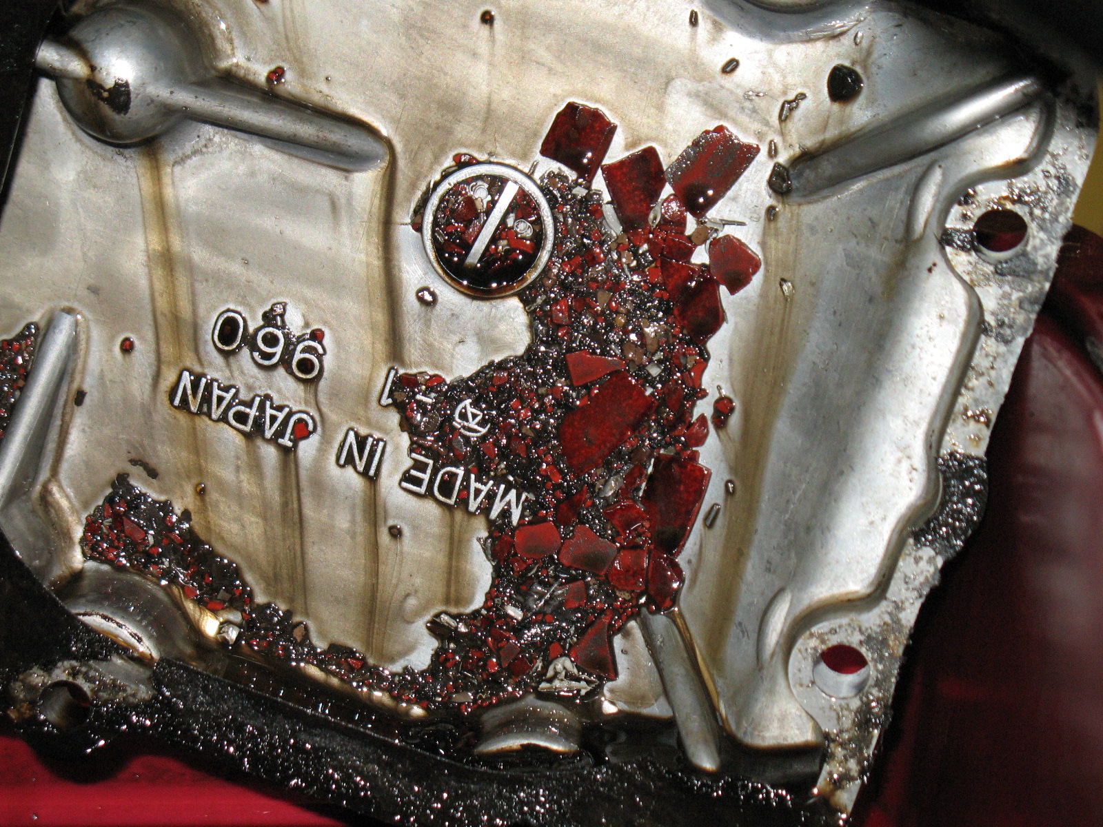

Plan to remove your oil pan to find missing magnet fragments. If the rotor magnets are not intact, the pieces will mostly be in the bottom of the oil pan, and some will be hiding in your stator windings.
I hope you aren't missing pieces like I was when this picture was taken in 2010. They had been hiding in there for awhile, before the decision to take a peek. Yummy!

As for the missing parts: I found more or less all pieces of the magnets, but not sure obout the red stuff. I noticed some of it when changing oil-mostly caught on the filter...Do you think it might have damaged the engine in any way? And if the oil pan clears the frame when remowing or do I have to pull the engine?

Far as the oil pan, the exhaust removal is all besides draining the oil and removing the filter. Engine stays put. Once you drop the pan, you will know what to do. On the side-stand, you will be able to look up inside the engine for remnant magnet pieces.
I found no traces of magnet or red stuff inside my engine, other than what was in the pan. Whew!
