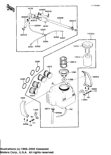

Thank you!, im not trying to drive it across the country or even into town. I just want to hear the bike idle and rev up. To see if I have any other problems that I will need to address. Im going to test my carb holders tonight for leaks. Im about to order a air filter offline, I cant find one at the parts store, But after looking at my air box, im a little confused about how it sits in there and mounts, I know it goes inside of it. But what im calling the cap that screws on the opening of the box that holds the air filter is not there, will the new air filter I order come with it? or is that a stock part? Im not having any luck trying to find topics that already cover the questions I have asked. If there is a topic on here that covers how to install the air filter, and how to re install the air box, please share the link lol. My bike did not have the air box installed when I got it.
This is my airbox, this is all I have. minus the rubber boots that attatch to each carb

The airbox in your picture is missing the airbox cap as you say. This is part # 11012 in the diagram (kawasaki.com owner info, parts diagrams etc etc) . The air filter does not come with the cap. If you had the cap you would just remove it, drop in the filter and replace it. According to kawasak.com the cap is no longer available
Also according to kawasaki.com the same cap was used on the following models so you may be able to pick one up on ebay or from a recycler
You might get it started with the pods or with duct tape around a portion of the pods.
