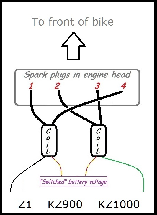

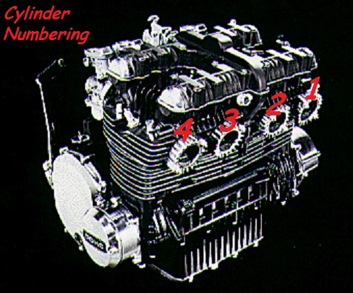

08 Nov 2012 10:15Surfdude_007 wrote: NO, the coils are not hooked up that way. Left side is one and four and the right side is two and three.
Yes exactly, 1-4 and 2-3. Now which two cylinders are cold, is it two on one coil? If so check the Primary circuit for power and the Ground charge signal to that coil. If thats good swap the coils around to see if the problem moves.

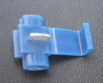

A splice-connector is sometimes used to connect the red wire to the red or red/yellow wire from the harness that feeds battery positive to the ignition coils. Such splice-connector sometimes fails.

The wire from left-hand Dyna-S module attaches to left-hand ignition coil that fires outside spark plugs #1 and #4.
The wire from right-hand Dyna-S module attaches to right-hand ignition coil that fires inside spark plugs #2 and #3.
