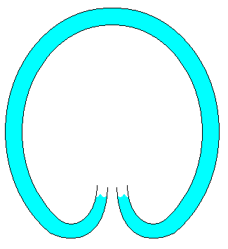

If both lines are routed in way that they both go below the oil level in the pan, the cooler won't drain. It doesn't matter having the lines connected to the top of the cooler or to the bottom.
Fill a hose with water, while holding the two ends, lift the hose above the two open ends like this:
The water will not drain out.
As long as both lower bends stay below oil level in the pan, they won't drain.
And yes, there's probably some exception depending on how the oil lines are routed in the motor. But I'm pretty sure the 550's oil cooler's don't drain until you drain the oil out of the motor.
