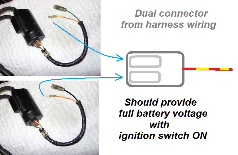

thanks guys, i dont have much time after work , but weekend is here! i have checked spark at plugs ,that is why i think its not getting gas. my fuel filter was matched with metal can type that was on there. gonna pull tank and do a flow check. thanks for video loud hvx! one more time with old battery . any way the valves could do this? also the 14 to 14.5 , is that across batt terminals or negative to hot side of coils ? thanks again and ill let everyone know what finally fixes this , no matter how embarrassing .

Check the battery voltage. Then check the voltage where the yellow/red wires go to the coils under the gas tank.
I always check the voltage going into the kill switch and the voltage coming out of the coil switch. Roy

25 May 2012 09:36
#524690
Good Fortune! :)

ok ,ckecked battery , still takes a charge , but only reads 12.2 volts at coils . cleaned connections to coils , no change. purchased new battery, starts immediately !#&@% bastard! dont have have a clue why a battery tests good , takes a charge and wont start a bike. thanks to every one for the help! now after this i have a clutch problem but ill start a new thread.

The batteries will just wear out. It might have good voltage but the cranking amps are down. Glad you got that sorted out. Roy
