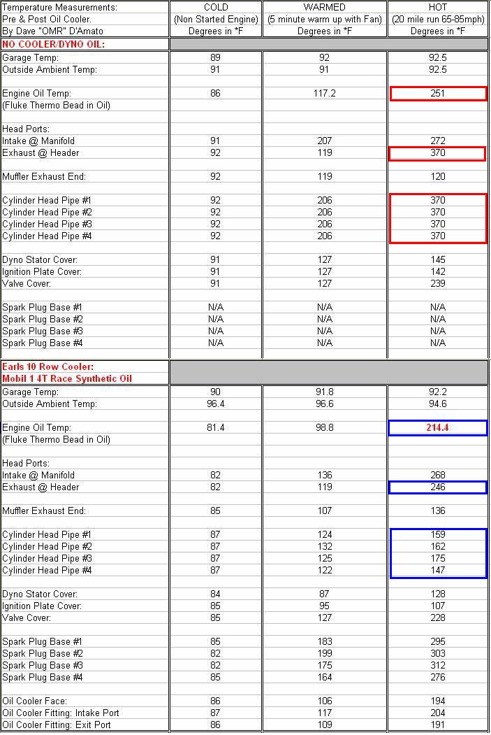

oil coolers will definitely remove heat from the oil, thus allow the oil to remove more heat from the engine. look at the post from OMR.
i think the ideal oil temp is 180*f. as stated above, oil will brake down at 240*.

I can't say for 2 strokers vs 4 strokes vs 810 vs 900/1000 but I can say it surprised the hell out of me of the temp differences Pre & Post measurements especially on the oil temp & exhaust ports.
Not so much on the actual values themselves for say but in the temp differences. Shit 30-40 degrees cooler in the oil temp measurement & 30-40% cooler on the exhaust temps! :ohmy:
