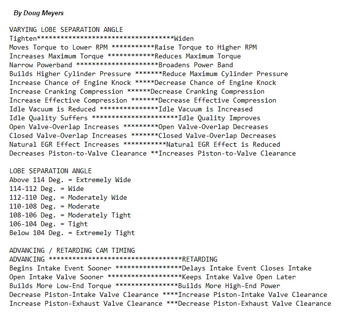

Okay guys, it's winter time here in northeast indiana so it's time to start messing with the bike again. I'm currently running the setup in my signature but just to put it up here, it's a 10.25:1 1075, stage one head from Larry, and k410 cams. Currently the cams are set to APE's specs which if I recall is 107.5/108.5 for lobe centers. The bike makes good power now but I want to get more out of it. Anybody have any suggestions for lobe centers? It actually runs really well now I just wanna move the power into a more street friendly position since it doesn't really start building a good head of steam until I get around 6-7k. Which brings up another question, exactly how hard can I safely rev this motor since I've been obeying the redline on the tach. Sorry for being long winded.

an easy way to remember what the lobe center changes will do, is think of low rpm's and low LC #'s.
so, if u decrease BOTH lcs #s (smaller #'s) your torque curve moves lower.
dont expect dramatic results. if u want bigger changes u need to change cams. less overlap = more compresion= more torque.
u wont get more power, just move the power around.untill u get to far from the designed #s, then u may loose power.
Larry would be able to give u more info on this. web cam has some info on there site, as do most cam manufacturers. but only u can deside what feels right for u, through trial.
as for reving higher. that depends on the wheight of your valve train and lift and spring strength. again, talk to Larry. if u have stock valves and Heavy springs u should be able to go to 10,000rpm with those cams.asuming u have ample valve to piston clearance. if the head has been decked then u are on your own.the other thing u need to know is, can u make power up to 10,000rpm? if it doesnt breath enough up there, there is no point reving that high.again, Larry has the #s for your ports.

If you want the most peak torque, close up the centers. If you want the torque spread out more, push them apart.
I'd say 106 on both will yield the highest peak number. 110 would spread it out more. We're talking about changes that would be most noticeable in a time slip.
Pulling a tight center on the intake can setup detonation with the crap fuel we have today. This shit is marginal at best....
I had a nice reply all typed up and this GD laptop ate my post :woohoo:
This keyboard totally sucks canal water!!!! I f'n hate it!!!!!
Anyway....now that's out of the way.....
