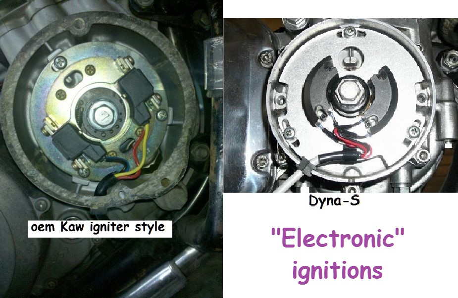

15 Oct 2011 08:49KZRider718 wrote: ...has electronic ignition....
Which electronic ignition? -- Could make a difference in diagnosis.
I.C. igniter or Dyna-S?
