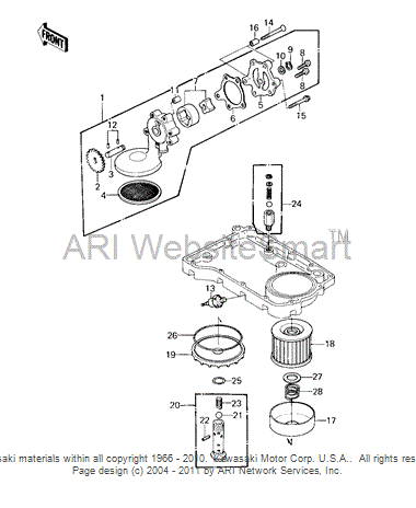

Oil weight/ viscosity can play into this. What oil are you using and the weight? Installing a pressure gauge to test the pressure is a good Idea, but could be to thin of oil. The switch could be a problem, and I would say that they are pretty inexpensive. But if oil weight is correct and you test the pressure and its low, then either the pump is worn or the bearing clearance is excessive at your crankshaft. Your manual will have the spec for oil pressure. You say "Low" RPM, what RPM is that? Is the Idle speed close to 1K?
If you look at this blow up of the pump and pressure regulator, you will see that the regulator, which dumps excessive pressure back to the sump, could possibly be stuck or a very weak/ broken spring. Group 24 in the picture.

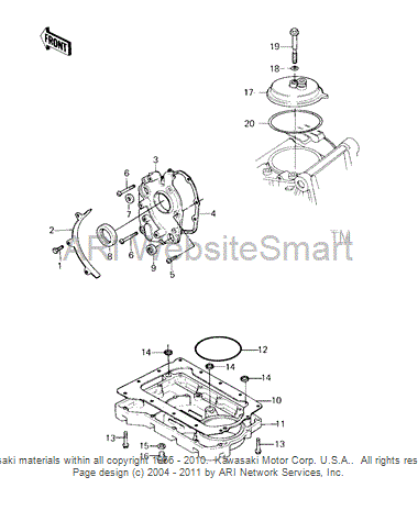

Also while not shown in this picture there are O-Rings at the oil pan to motor for oil galley that could possibly leak some pressure back to the sump.
They are #14 in this picture.
