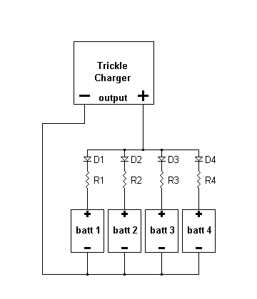

The regulator, in that case, is just a limiter so the voltage does not go too high.
I'll draw a fan out diagram just so we're on the same page.

Yes, if you can get a cheap solar array, that may be the way to go, especially if they are more powerful.
The thing is, making this sort of thing needs some thorough testing. You don't want to go up in smoke.
You want the array output low enough that it is easy to regulate, but then you want it to be powerful enough to work on cloudy days.
I haven't worked with solar arrays, but I get the sense that any clouds really kill off the power output.
There is a chance that you might even be able to use a Kz voltage regulator. They are designed for AC input, but will also take DC input. As long as your array is not too powerful, the Kz regulator should be able to handle it. If the array is too powerful, you can reduce the output with a big resistor or diode.
The diagram below does not show the regulator or array, just a generic, weak power source putting out about 14 to 15v.
The diodes give the isolation. The resistors balance the load between the batteries. They are in the 1 ohm range, and 1 to 5 watts, depending on how powerful the power source is.
