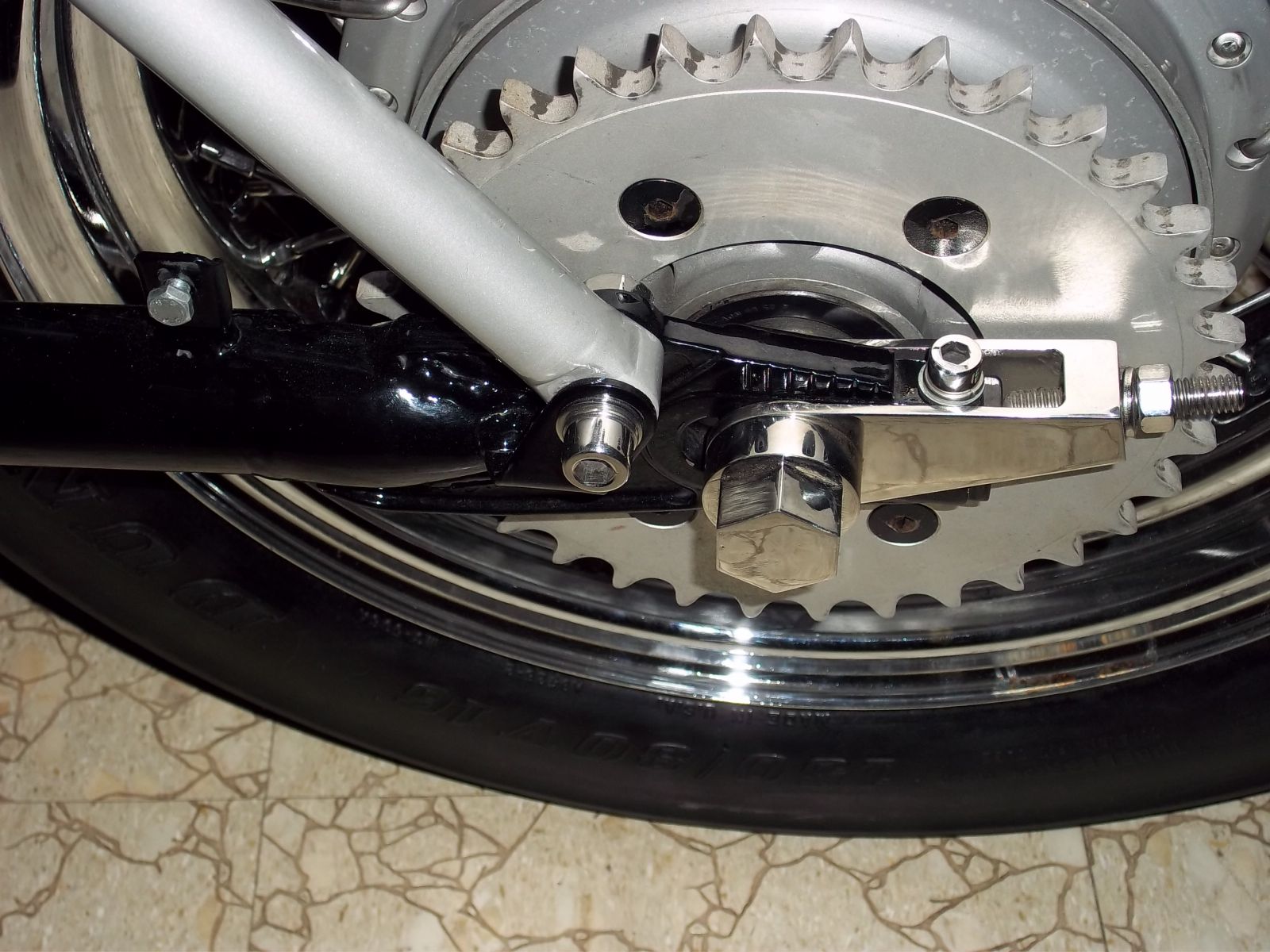

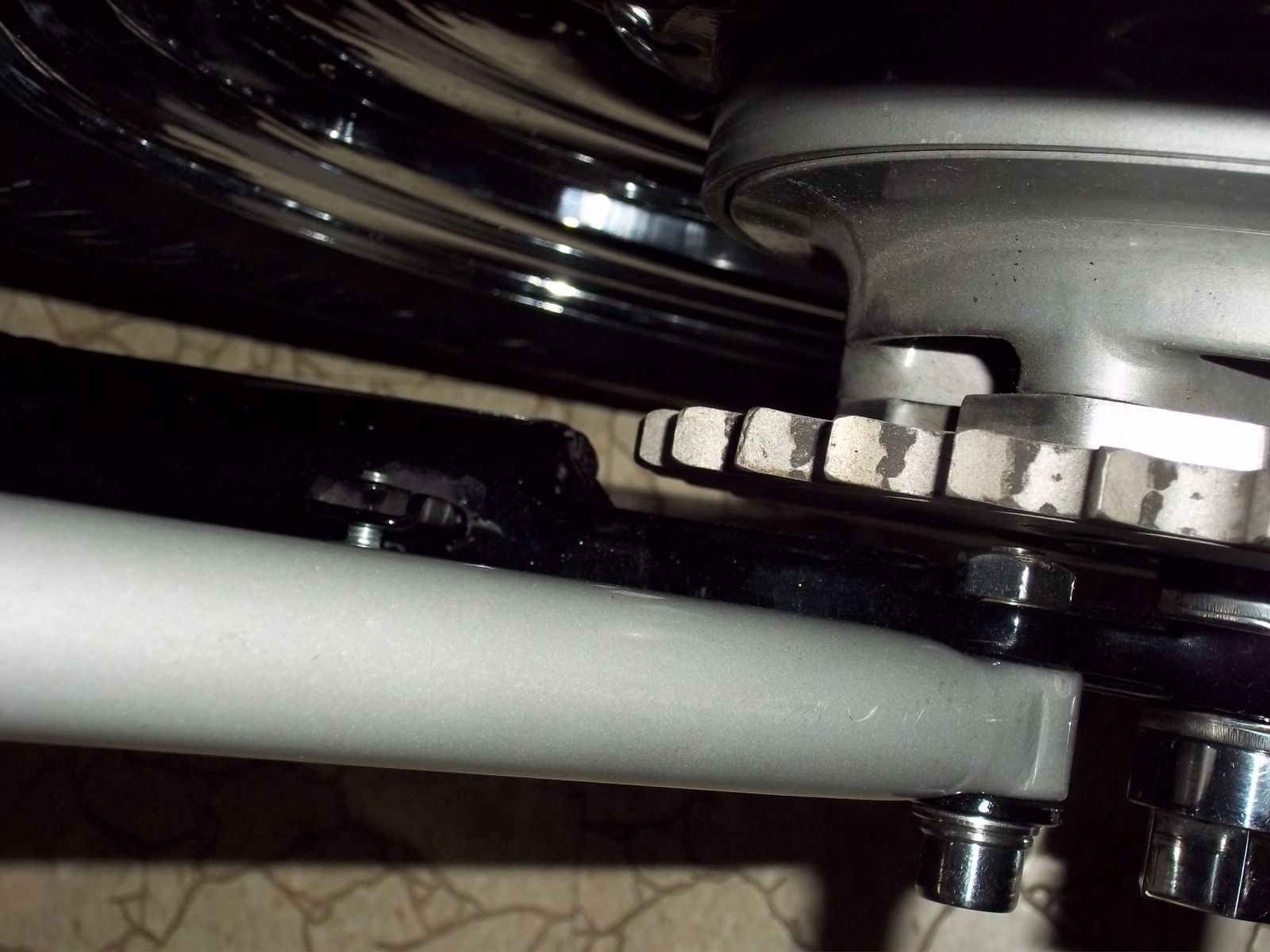

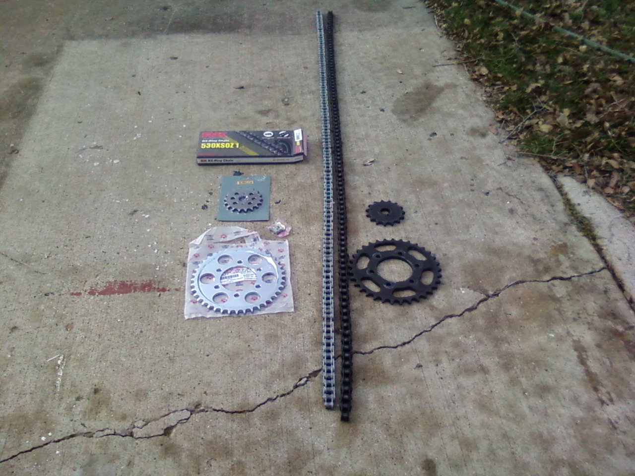

11 Nov 2015 08:06 - 11 Nov 2015 08:07I'm going to change. I need 530. But I built a swing arm 15 years ago. with all stock dimensions and offset the rear with 3/8" Also the front sprocket is 3/8 also. So I had to use an aluminum sprocket as to let me countersink sprocket bolts flat for clearance. So I can only use a 32 tooth max. for the rear. I even notched out the swing arm. Gives me a 2:13 final ratio. Stock Z1-KZ900 are 2:33. I have to make or find a conversion 530 sprocket to equal a 630 - 32 teeth. Which is about 39 teeth in 530 for drum brake Z1 or H2
Gary larson sells all kinds of PBI sprockets. He has a website and ebay store.
They make 16-17-18-19 for the front. This will bring back some low end.
I was not thinking many moons ago. To make it worse I mocked it up with HD EK chain for drag bike. weighs about 10 pounds.
This bike won't be driven much. If I convert I can increase the rear tire from 150 maybe get a 180 in
But to answer your question. If you want less weight and less energy to turn the wheel go for it.
Good quality chain is better than stock 630. Pro Stock drag bikes ran 530 for years.
