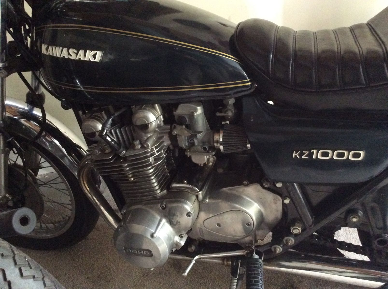

Hi, just recently picked up a 77kz 1000 any one have a checklist for used bike tune up top to bottom? Thx in advance

It has been sitting according to seller it sat for 5 years and he got it cleaned carbs got it running (poorly) . I just got it a few days ago the fuel lines he had on there were about a foot long from petcock to carb, I cut them down to size giving the just a couple extra inches. It ran better after that but I'm going to go through the whole tune checklist just like Ido with any new project. I'm asking for a list for this specific bike because I know there's subtle differences from model to model and even year to year, plus I've never had a kz1000' had a 77 kz650 which is what was looking for when I ran into this one, So thanks for the advice I will be using all the recourses from this site manuals and asking a lot of Qs. Let the good times roll eh!
