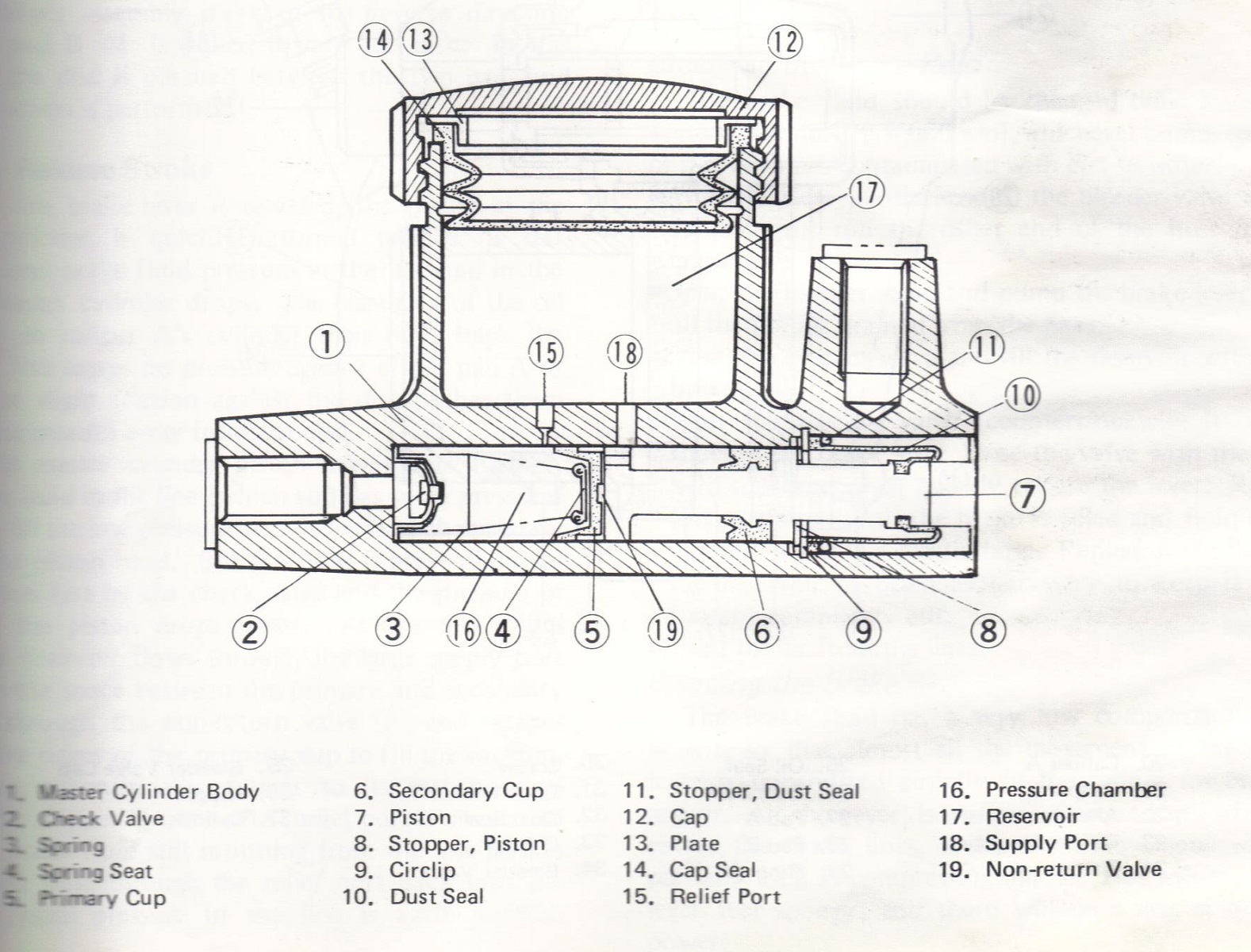

I'm getting my KZ900 ready too, but discovered the front brake is locking up - what would cause that?

13 Mar 2015 08:28 - 13 Mar 2015 11:04toolmaker wrote: I'm getting my KZ900 ready too, but discovered the front brake is locking up - what would cause that?
One possible cause could be a clogged relief port in the master cylinder.
It's the smaller of the two ports (orifices) connecting the bore to and from the reservoir.
The relief port allows the brake fluid pressure to neutralize/relax when the hand brake lever is released so that the front brake is no longer being applied.
The relief port size may be compared to a pin-hole.
When the front brake fails to fully release, friction of the pads against the rotor creates heat, which keeps tightening the brake until it eventually locks up.

If cracking the bleeder on the caliper doesn't relieve the pressure that a blocked relief port might cause I would suspect that the piston in the caliper is seized up by gunk and possibly corrosion between the piston and the caliper body.
