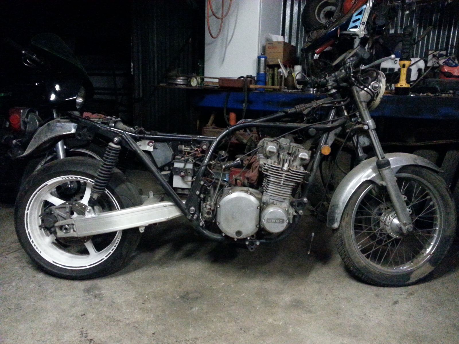

No eBay APP ID and/or Cert ID defined in Kunena configurationif you want a 190 and a three inch extension the
needs some machining of the pivot,but makes a nice conversion arm aswell.
here is a 900 i have one in.
