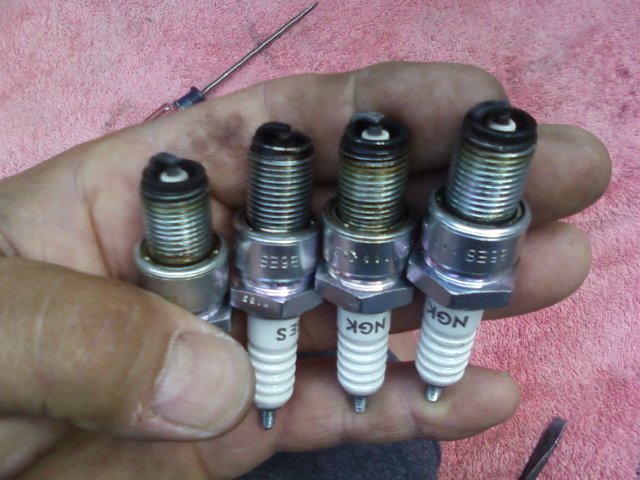

OK, it looks like a bad/fouled plug on # 2 cylinder .
I swapped it with a good plug and it is sparking fine on # 2
It looks like the other three plugs are running too hot, Z1E sent us NGK B6E S but the book calls for NGK B7E S , are the B6E's hotter then the B7E's ?
Also checked the rear sprocket and it is a 42 tooth, Zach said that he made a mistake when he told me the RPM's vs MPH, turns out it is as Ed says at 4500 at 60 mph.
After we get fresh plugs and change out the oil I'll take it for a spin and see what I come up with,
When I rode it before I really hammered it and took it way passed the speed and RPM's that Zach will go hopefully for a long time and it had no clutch slippage. B)as a matter of fact she screamed , this bike is probably quicker off the line and much better handling then the 1000

B6ES is too hot to use in the KZ650. You should use either NGK B7ES or ND W22ES-U plugs. They are the correct heat range for the engine. Personally, I prefer the ND W22ES-U plugs. Ed

Thanks Ed that's just what I needed to hear, time to take a ride into town
