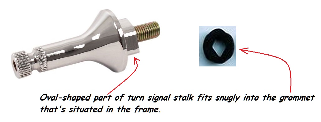

Re: Adding Saddlebags to an '82 KZ750 Twin
27 Mar 2013 01:13
When fitting the stock blinkers, I found that the stock turn signal stalks (stems) were difficult to relocate (due to the oval grommet arrangement), so different stalks were fitted -- the simple style that aren't rubber mounted.
These are the stock turn signal stalks:
