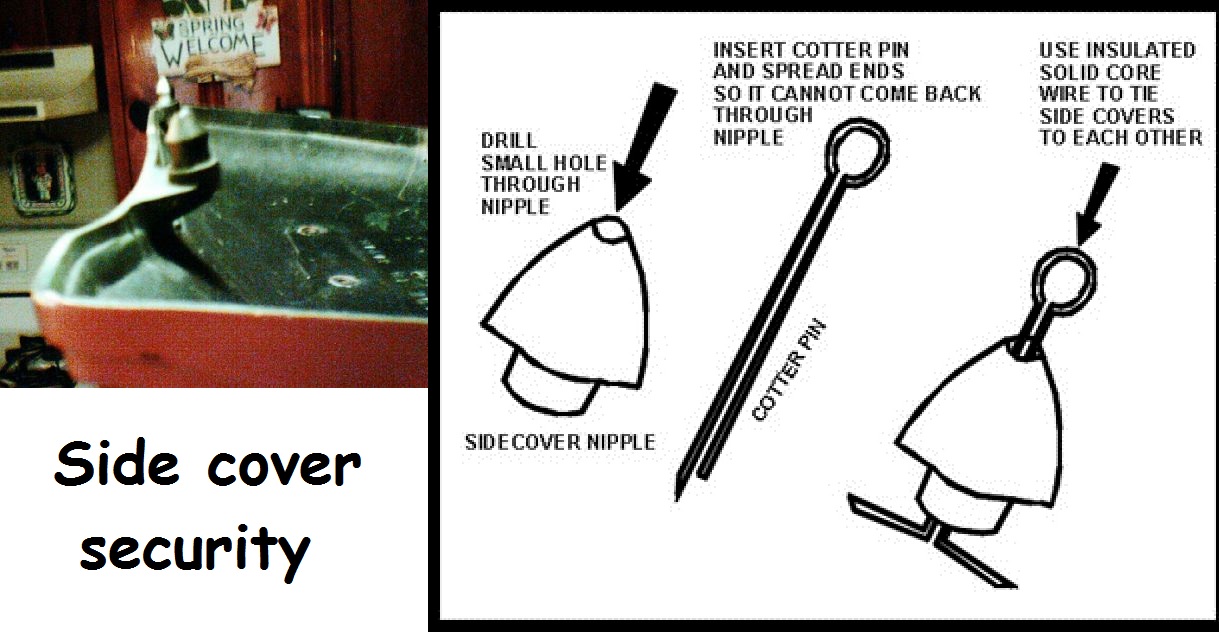

I rode over to my GF's house about 15 miles away and went to leave ,I noticed I lost my left sidecover
(( $%%^*$#@!!!!!))those were my words. Pissed
road home same way and bingo ,,lying on the side of the road in the weeds there it was .
Very minor scape thats it.. Little black spray paint yee haa !!!

Couple of options for better side cover security.
Good Fortune! :)
