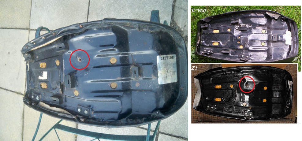

#505351
Attachment 100_2527.jpg not found
Managed to get a picture of the bottom. Here it is.

Re: KZ seat
21 Feb 2012 00:15
#505388
Looks like it could be a Z1 seat pan.
The single threaded hole could be for the Z1 seat's pointed post that fits into the Z1 seat lock.

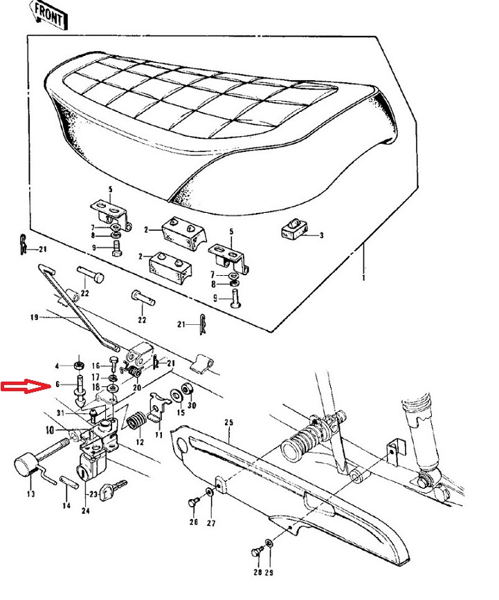

Re: KZ seat
21 Feb 2012 00:19
#505389
Z1 seat's pointed post.
