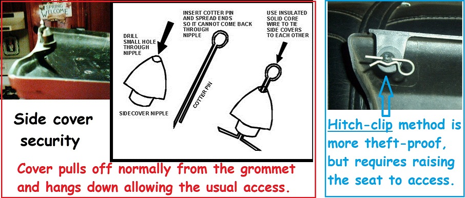

somebody else was talking about pinning side covers on the other day to keep them from blowing off,couldnt find the post so im starting a new one here if i can get the picture to post.
this is the reason i suggest drilling a hole in front corner of cover and safety wiring it around the frame tube,that way if something starts smoking you can get at it a hell of a lot faster than trying to open seat and pull out a bunch of pins to get it off . :sick:
