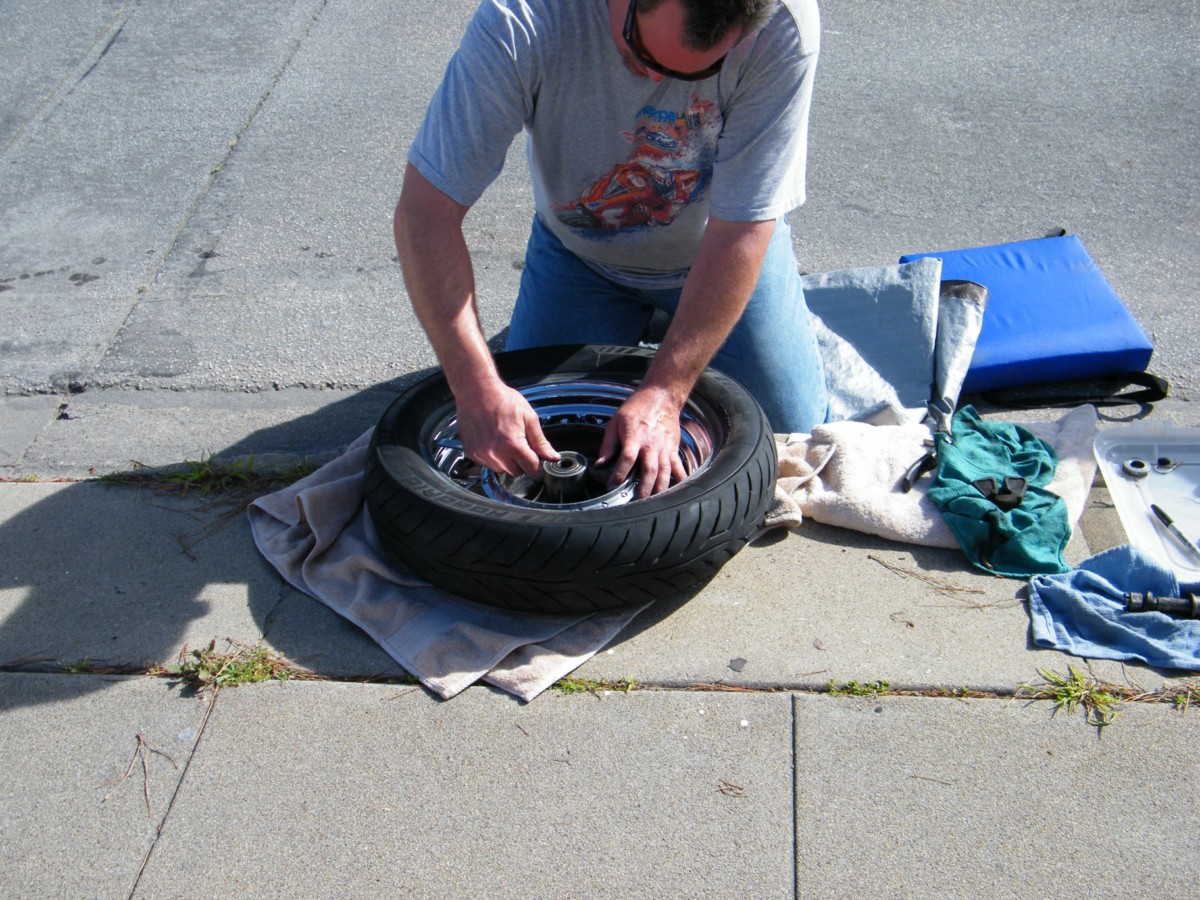

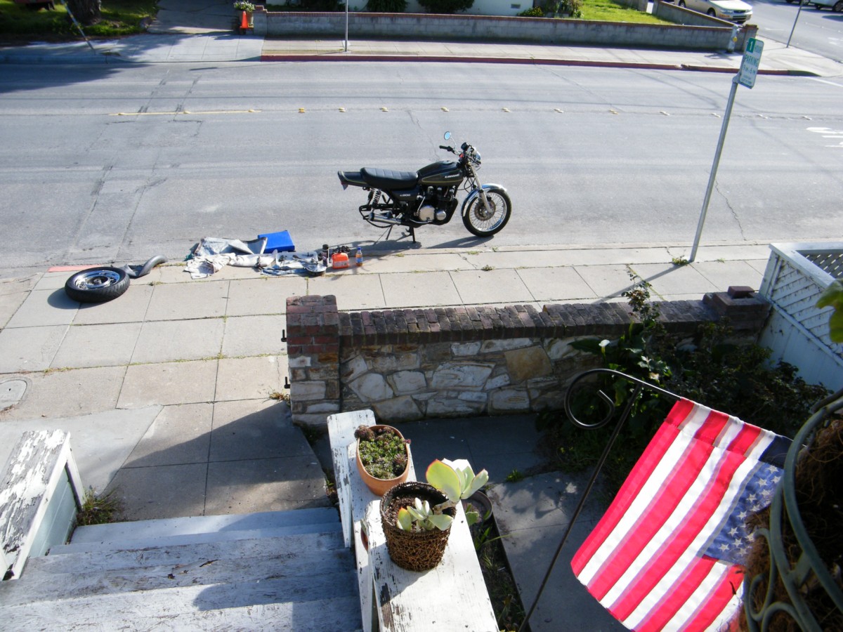

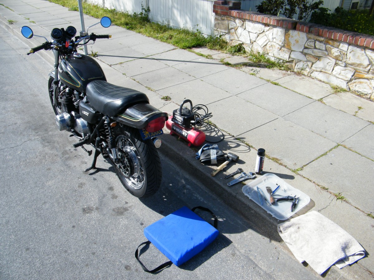

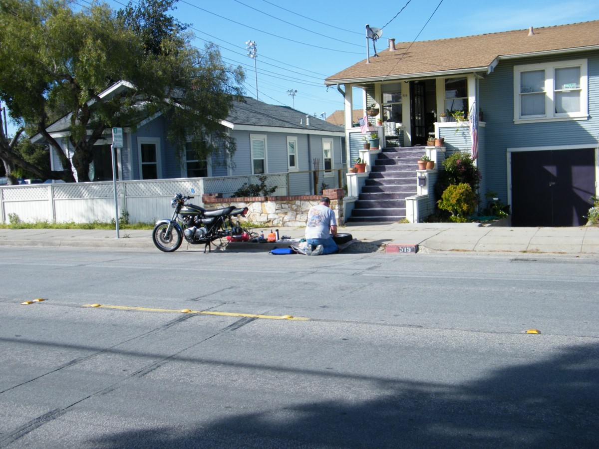

well i fixed the tire today in the middle of the street with the old slow leak tube for now and ordered a new one...made it home,even got a nice ride in and a few pics...but first...i win the banana this year i think
I make mistakes...not all the time and not always big ones...but this is a big one...
It was all my fault...here goes....dont tear me a new one, believe me i feel bad enough already...
the story deserves telling though imo
got off work and loaded what i might need to do a clean tire change(tube)on the side of a street...
the tire had a weird bruise or hot spot...i thought ,when it first happened that this was a skid i had done
earlier to find out why the bike felt so weird....it must have had some skid there and when it got hot left a bruise?
but more later on that one spot...the whole tire looked cooked a tad from going a few hundered feet at heat
did a little tire work in the street

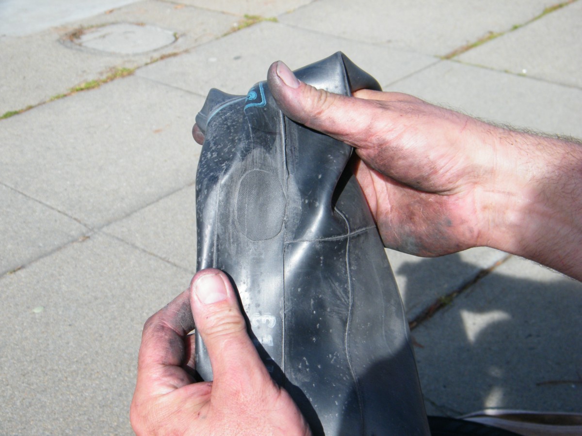

inspected the patch....hmmm seems tight enough...did not wanna waste my tank of air to test the tube for a leak spot.....
cool people that let me park overnight...Amy was chatting away with the lady and her parrots
cool little beach house

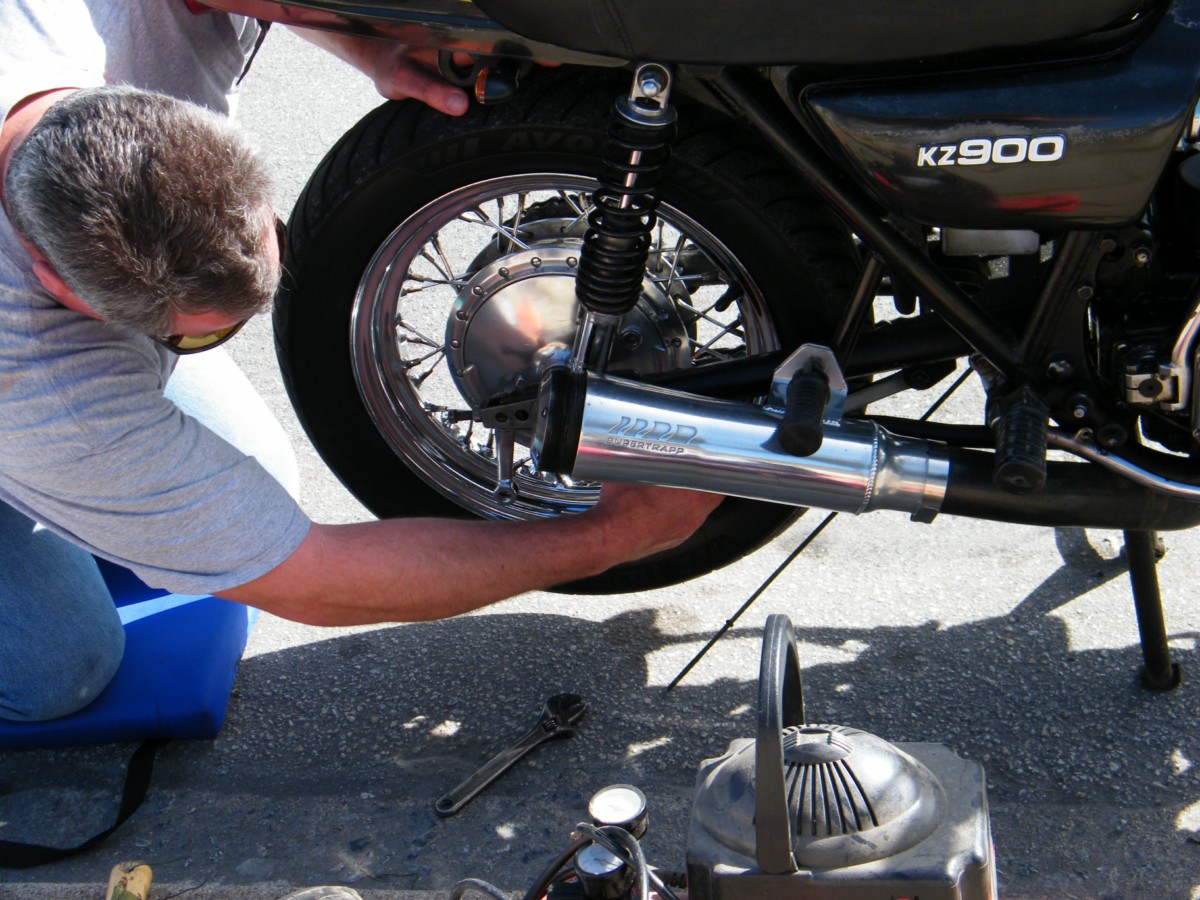

folks had mentioned running my hand inside the tire to feel for sharp stuff...did that nothing ,some more,nothing,hey whats this rolling inside when i rotate the tire??????????
[attachment:10]i found this.JPG[/attachment]
hmmmmm looks like that plug wrench i use as a third iron that i had sent flying the day i was changing the tube...hmmmm...i thought i lost it in the driveway?????
[attachment:11]straight bullshit!!!.JPG[/attachment]
seems i put it in my tire for safe keeping...good thing i'm so smart...good thing i gave looking for it after a few minutes....good thing those teenagers from next door were hanging out talking to me.it is their fault right???...good thing i am so smart....:blush:
[attachment:12]how did that get in there.JPG[/attachment]
oh well ,i guess that was that weird feeling the bike had...you know the ole...plug wrench inside your tire feeling..
i kept thinking i should go home...something is way wrong...what could be that bad...hmmm..ride it and see what happens:pinch:
anyways....amazing and i am at fault...it is about the best mistake with bikes i have ever made...or up there at least.....it flung off so fast i thought it went in the weeds or some where else....i had not popped both beads the first try thinking the valve side was enough to squeeze a hand in and retrieve the tube...the extra fight against the outer/lower bead was my first mistake and not finding the wrench that shot away,i thought it did! :blink: ,was my almost fatal error...

Whoa, I'm not gonna bust your balls because it's an important story to tell. Just glad to hear you didn't bite it on that deal. I like to think that I change my own tires/do my own maintenance so that some goon at the tire shop doesn't do something like this to me. You make a very good point about being tired and distracted. That's exactly what leads to mistakes. I know my kids are usually running around outside while I'm working on a bike. They always ask a thousand questions, and it's easy to get distracted.
And, I thought you were gonna find a drywall screw in there. Damn, a plug wrench! It's a good thing that the wrench didn't burrow out of the tire. :sick:
